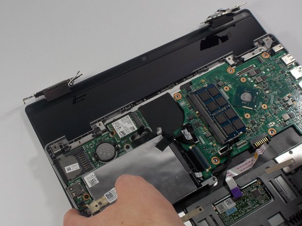

  8. Dell Inspiron 11-3152 Screen Replacement, Screen: crwdns2935265:08crwdnd2935265:01crwdnd2935265:01crwdne2935265:0
    • Unscrew the brackets in the top right and top left of the laptop. Unscrew the two 1mm screw from both of the brackets on both sides with #0 phillips head.
  9. Dell Inspiron 11-3152 Screen Replacement: crwdns2935265:09crwdnd2935265:01crwdnd2935265:01crwdne2935265:0
    • Disconnect the aerial cables from the wireless controller by pulling them away from the laptop.
  10. Dell Inspiron 11-3152 Screen Replacement: crwdns2935265:010crwdnd2935265:01crwdnd2935265:01crwdne2935265:0
    • Push the brackets up on both sides with your hands or spudger.
  11. Dell Inspiron 11-3152 Screen Replacement: crwdns2935265:011crwdnd2935265:01crwdnd2935265:02crwdne2935265:0 Dell Inspiron 11-3152 Screen Replacement: crwdns2935265:011crwdnd2935265:02crwdnd2935265:02crwdne2935265:0
    • At this point you can pull the bottom half of the computer away from the screen.
    • The screen is now fully detached and ready to be replaced!
