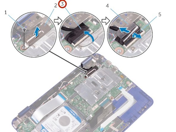

  1. Dell Inspiron 11 3179 Display Assembly Replacement, Remove the Screw: crwdns2935265:01crwdnd2935265:01crwdnd2935265:01crwdne2935265:0
  2. Dell Inspiron 11 3179 Display Assembly Replacement, Lifting the Display Cable: crwdns2935265:02crwdnd2935265:01crwdnd2935265:01crwdne2935265:0
    • Lift the display-cable bracket off the system board.
  3. Dell Inspiron 11 3179 Display Assembly Replacement, Peeling the Tape: crwdns2935265:03crwdnd2935265:01crwdnd2935265:01crwdne2935265:0
    • Peel off the tape to access the display cable.

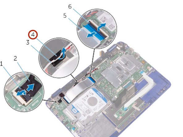

  4. Dell Inspiron 11 3179 Display Assembly Replacement, Disconnecting the Display Cable: crwdns2935265:04crwdnd2935265:01crwdnd2935265:02crwdne2935265:0 Dell Inspiron 11 3179 Display Assembly Replacement, Disconnecting the Display Cable: crwdns2935265:04crwdnd2935265:02crwdnd2935265:02crwdne2935265:0
    • Open the latch and disconnect the display cable.

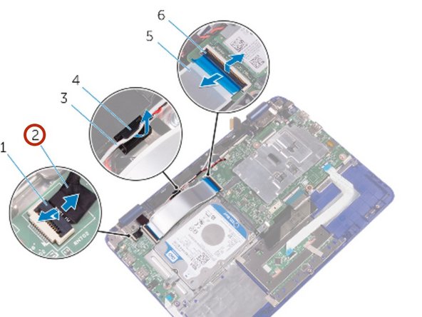

  5. Dell Inspiron 11 3179 Display Assembly Replacement, Disconnecting the Sensor-Board Cable: crwdns2935265:05crwdnd2935265:01crwdnd2935265:02crwdne2935265:0 Dell Inspiron 11 3179 Display Assembly Replacement, Disconnecting the Sensor-Board Cable: crwdns2935265:05crwdnd2935265:02crwdnd2935265:02crwdne2935265:0
    • Open the latch and disconnect the sensor-board cable from the I/O board.
  6. Dell Inspiron 11 3179 Display Assembly Replacement, Remove the Antenna Cable: crwdns2935265:06crwdnd2935265:01crwdnd2935265:02crwdne2935265:0 Dell Inspiron 11 3179 Display Assembly Replacement, Remove the Antenna Cable: crwdns2935265:06crwdnd2935265:02crwdnd2935265:02crwdne2935265:0
    • Remove the antenna cable from the routing guide on the right speaker.
  7. Dell Inspiron 11 3179 Display Assembly Replacement, Open the Latch: crwdns2935265:07crwdnd2935265:01crwdnd2935265:01crwdne2935265:0
    • Open the latch and disconnect the I/O-board cable from the system board.
  8. Dell Inspiron 11 3179 Display Assembly Replacement, Peeling the Tapes: crwdns2935265:08crwdnd2935265:01crwdnd2935265:01crwdne2935265:0
    • Peel the tapes off the display hinges.
