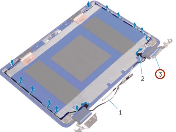

    • Peel the tapes and remove the antenna cables from the routing guide on the hinge cover.
  2. Dell Inspiron 11 3169 Display Hinges Replacement, Remove the Screws: crwdns2935265:02crwdnd2935265:01crwdnd2935265:01crwdne2935265:0
    • Remove the screws that secure the display hinges to the display back-cover and antenna assembly.
  3. Dell Inspiron 11 3169 Display Hinges Replacement, Lifting the Hinges: crwdns2935265:03crwdnd2935265:01crwdnd2935265:02crwdne2935265:0 Dell Inspiron 11 3169 Display Hinges Replacement, Lifting the Hinges: crwdns2935265:03crwdnd2935265:02crwdnd2935265:02crwdne2935265:0
    • Lift the display hinges off the display back-cover and antenna assembly.
  4. Dell Inspiron 11 3169 Display Hinges Replacement, Align the Screw Holes: crwdns2935265:04crwdnd2935265:01crwdnd2935265:01crwdne2935265:0
    • Align the screw holes on the NEW display hinges with the screw holes on the display back-cover and antenna assembly.
  5. Dell Inspiron 11 3169 Display Hinges Replacement, Replace the Screws: crwdns2935265:05crwdnd2935265:01crwdnd2935265:01crwdne2935265:0
    • Replace the screws that secure the display hinges to the display back-cover and antenna assembly.
  6. Dell Inspiron 11 3169 Display Hinges Replacement, Route the Antenna Cables: crwdns2935265:06crwdnd2935265:01crwdnd2935265:02crwdne2935265:0 Dell Inspiron 11 3169 Display Hinges Replacement, Route the Antenna Cables: crwdns2935265:06crwdnd2935265:02crwdnd2935265:02crwdne2935265:0
    • Route the antenna cables through the routing guide on the hinge cover and secure it in place.
