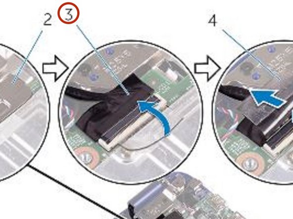

  3. Dell Inspiron 11 3169 Display Assembly Replacement, Peeling off the Tape: crwdns2935265:03crwdnd2935265:01crwdnd2935265:02crwdne2935265:0 Dell Inspiron 11 3169 Display Assembly Replacement, Peeling off the Tape: crwdns2935265:03crwdnd2935265:02crwdnd2935265:02crwdne2935265:0
    • Peel off the tape to access the display cable.

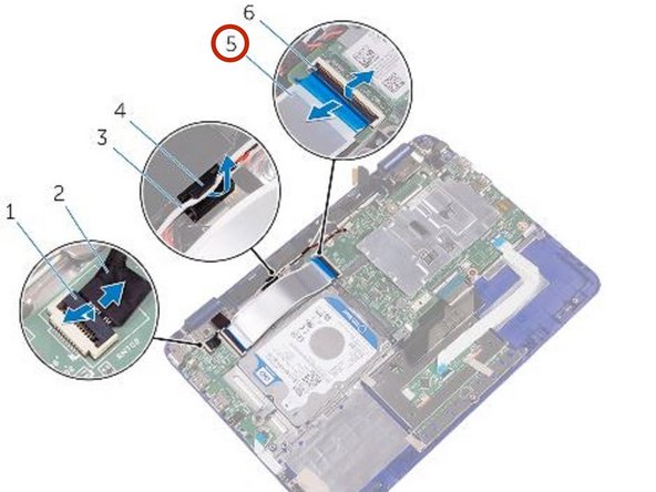

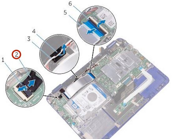

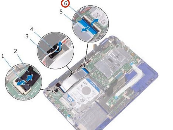

  4. Dell Inspiron 11 3169 Display Assembly Replacement, Open the Latch: crwdns2935265:04crwdnd2935265:01crwdnd2935265:01crwdne2935265:0
    • Open the latch and disconnect the display cable.
  5. Dell Inspiron 11 3169 Display Assembly Replacement, Open the Latch: crwdns2935265:05crwdnd2935265:01crwdnd2935265:03crwdne2935265:0 Dell Inspiron 11 3169 Display Assembly Replacement, Open the Latch: crwdns2935265:05crwdnd2935265:02crwdnd2935265:03crwdne2935265:0 Dell Inspiron 11 3169 Display Assembly Replacement, Open the Latch: crwdns2935265:05crwdnd2935265:03crwdnd2935265:03crwdne2935265:0
    • Open the latch and disconnect the sensor-board cable from the I/O board.
  6. Dell Inspiron 11 3169 Display Assembly Replacement, Peeling the Tapes: crwdns2935265:06crwdnd2935265:01crwdnd2935265:01crwdne2935265:0
    • Peel the tapes off the display hinges.

  13. Dell Inspiron 11 3169 Display Assembly Replacement, Sliding the I/O Board Cable: crwdns2935265:013crwdnd2935265:01crwdnd2935265:02crwdne2935265:0 Dell Inspiron 11 3169 Display Assembly Replacement, Sliding the I/O Board Cable: crwdns2935265:013crwdnd2935265:02crwdnd2935265:02crwdne2935265:0
    • Turn the computer over and close the display.
    • Slide the I/O-board cable into its slot on the system board and press down the latch to secure the cable.
  14. Dell Inspiron 11 3169 Display Assembly Replacement, Routing the Antenna Cable: crwdns2935265:014crwdnd2935265:01crwdnd2935265:01crwdne2935265:0
    • Route the antenna cable through its routing on the right speaker.
  15. Dell Inspiron 11 3169 Display Assembly Replacement, Sliding the Sensor-Board Cable: crwdns2935265:015crwdnd2935265:01crwdnd2935265:02crwdne2935265:0 Dell Inspiron 11 3169 Display Assembly Replacement, Sliding the Sensor-Board Cable: crwdns2935265:015crwdnd2935265:02crwdnd2935265:02crwdne2935265:0
    • Slide the sensor-board cable into its slot on the I/O board and press down the latch to secure the cable.
  16. Dell Inspiron 11 3169 Display Assembly Replacement, Sliding the Display Cable: crwdns2935265:016crwdnd2935265:01crwdnd2935265:01crwdne2935265:0
    • Slide the display cable into its slot on the system board and press down the latch to secure the cable.
  17. Dell Inspiron 11 3169 Display Assembly Replacement, Adhering the Tape: crwdns2935265:017crwdnd2935265:01crwdnd2935265:01crwdne2935265:0
    • Adhere the tape on the display cable.
