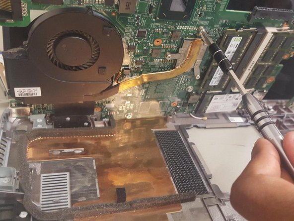

    • First turn over your computer and remove all of the rubber stoppers on the back.
  2. Dell Inspirion 15z-5523 Fan Replacement: crwdns2935265:02crwdnd2935265:01crwdnd2935265:01crwdne2935265:0
    • Then remove all the screws that were under the rubber stoppers.
  3. Dell Inspirion 15z-5523 Fan Replacement: crwdns2935265:03crwdnd2935265:01crwdnd2935265:01crwdne2935265:0
    • Take the screw out of the back plate.
  4. Dell Inspirion 15z-5523 Fan Replacement: crwdns2935265:04crwdnd2935265:01crwdnd2935265:01crwdne2935265:0
    • Remove back plate by grabbing and lifting up.
  5. Dell Inspirion 15z-5523 Fan Replacement: crwdns2935265:05crwdnd2935265:01crwdnd2935265:01crwdne2935265:0
    • Remove CD port by pulling it straight out.
  6. Dell Inspirion 15z-5523 Fan Replacement: crwdns2935265:06crwdnd2935265:01crwdnd2935265:01crwdne2935265:0
    • Remove the keyboard.
  7. Dell Inspirion 15z-5523 Fan Replacement: crwdns2935265:07crwdnd2935265:01crwdnd2935265:01crwdne2935265:0
    • Take screw out of the surface below the keyboard and remove the top layer of the computer off of the base.
  8. Dell Inspirion 15z-5523 Fan Replacement: crwdns2935265:08crwdnd2935265:01crwdnd2935265:01crwdne2935265:0
    • Remove the battery by unscrewing the 5 screws and pull straight out.
  9. Dell Inspirion 15z-5523 Fan Replacement: crwdns2935265:09crwdnd2935265:01crwdnd2935265:01crwdne2935265:0
    • Remove the three screws from the hard drive and remove by pulling straight out.
  10. Dell Inspirion 15z-5523 Fan Replacement: crwdns2935265:010crwdnd2935265:01crwdnd2935265:02crwdne2935265:0 Dell Inspirion 15z-5523 Fan Replacement: crwdns2935265:010crwdnd2935265:02crwdnd2935265:02crwdne2935265:0
    • Unscrew motherboard and remove the two clips.
  11. Dell Inspirion 15z-5523 Fan Replacement: crwdns2935265:011crwdnd2935265:01crwdnd2935265:02crwdne2935265:0 Dell Inspirion 15z-5523 Fan Replacement: crwdns2935265:011crwdnd2935265:02crwdnd2935265:02crwdne2935265:0
    • Flip motherboard up, unscrew the three screws, and unclip the fan.
