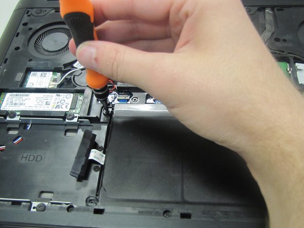

    • Use a Phillips #0 screwdriver to remove the three 2.5 mm screws from the battery brackets.
  4. Dell G7 15-7588 RAM Replacement: crwdns2935265:04crwdnd2935265:01crwdnd2935265:01crwdne2935265:0
    • Grab both sides of the battery connector.
    • Pull the battery connector straight back to disconnect it from the laptop.
    • This will completely disconnect the batter from the laptop.

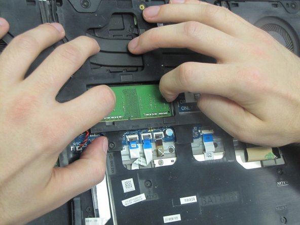

  5. Dell G7 15-7588 RAM Replacement: crwdns2935265:05crwdnd2935265:01crwdnd2935265:02crwdne2935265:0 Dell G7 15-7588 RAM Replacement: crwdns2935265:05crwdnd2935265:02crwdnd2935265:02crwdne2935265:0
    • Push the sides of the metal retention clips outward.
    • This will release the RAM from its locked state and cause it to rise upward, allowing for removal.
    • The same method is used for both pieces of RAM.

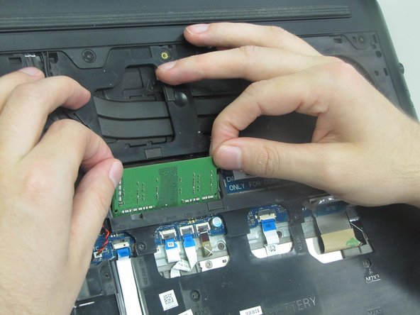

  6. Dell G7 15-7588 RAM Replacement: crwdns2935265:06crwdnd2935265:01crwdnd2935265:02crwdne2935265:0 Dell G7 15-7588 RAM Replacement: crwdns2935265:06crwdnd2935265:02crwdnd2935265:02crwdne2935265:0
    • Remove the RAM from the laptop by pulling it up from the slot.
