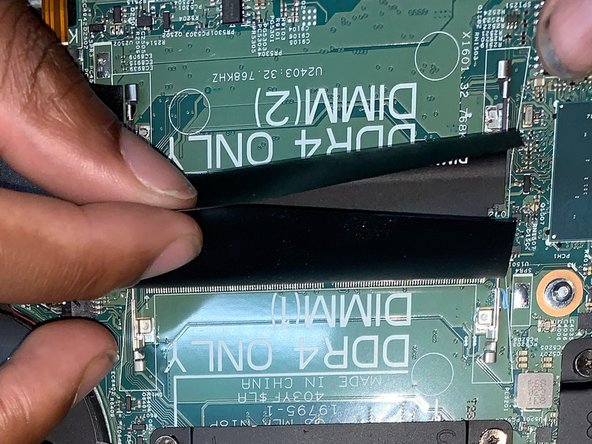

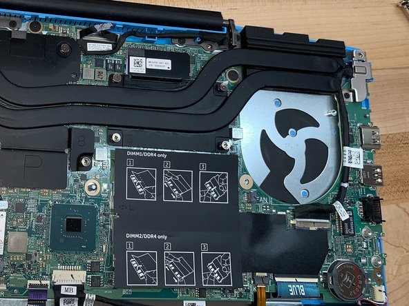

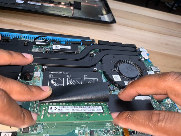

  9. Dell G3 3500 Disassembly, Remove the RAM modules: crwdns2935265:09crwdnd2935265:01crwdnd2935265:03crwdne2935265:0 Dell G3 3500 Disassembly, Remove the RAM modules: crwdns2935265:09crwdnd2935265:02crwdnd2935265:03crwdne2935265:0 Dell G3 3500 Disassembly, Remove the RAM modules: crwdns2935265:09crwdnd2935265:03crwdnd2935265:03crwdne2935265:0
    • Locate the RAM modules.
    • Fold back the black protective cover and gently press the sides until each RAM module pops up.
    • Remove the modules from the board.

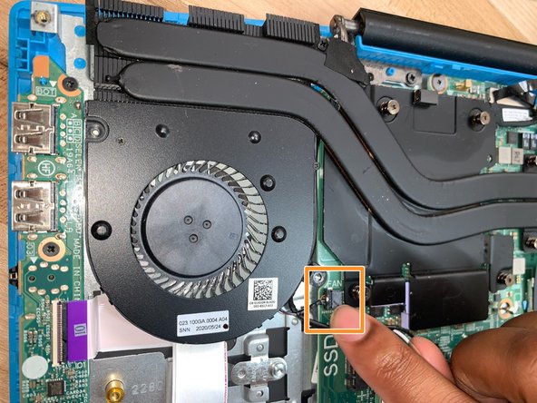

  10. Dell G3 3500 Disassembly, Remove the left fan: crwdns2935265:010crwdnd2935265:01crwdnd2935265:03crwdne2935265:0 Dell G3 3500 Disassembly, Remove the left fan: crwdns2935265:010crwdnd2935265:02crwdnd2935265:03crwdne2935265:0 Dell G3 3500 Disassembly, Remove the left fan: crwdns2935265:010crwdnd2935265:03crwdnd2935265:03crwdne2935265:0
    • Locate the left fan and unscrew both #1 Philips head screws.
    • Unplug the left fan from the device and pull it away from the device.
  11. Dell G3 3500 Disassembly, Remove the right fan: crwdns2935265:011crwdnd2935265:01crwdnd2935265:03crwdne2935265:0 Dell G3 3500 Disassembly, Remove the right fan: crwdns2935265:011crwdnd2935265:02crwdnd2935265:03crwdne2935265:0 Dell G3 3500 Disassembly, Remove the right fan: crwdns2935265:011crwdnd2935265:03crwdnd2935265:03crwdne2935265:0
    • Locate the right fan and unscrew both #1 Philips head screws.
    • Unplug the right fan and pull away from the device.

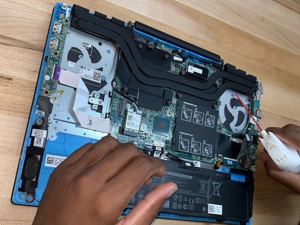

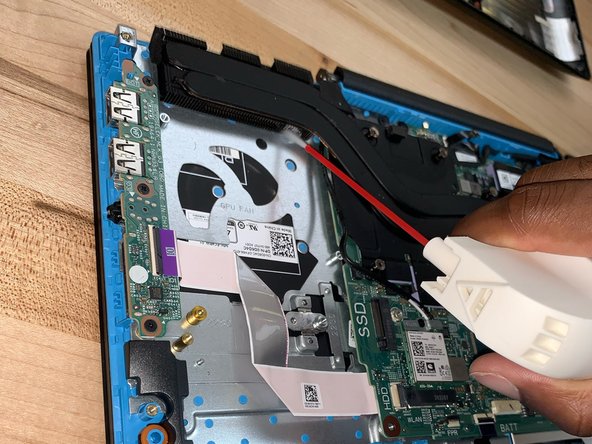

  12. Dell G3 3500 Disassembly, Clean with a compressed air can: crwdns2935265:012crwdnd2935265:01crwdnd2935265:03crwdne2935265:0 Dell G3 3500 Disassembly, Clean with a compressed air can: crwdns2935265:012crwdnd2935265:02crwdnd2935265:03crwdne2935265:0 Dell G3 3500 Disassembly, Clean with a compressed air can: crwdns2935265:012crwdnd2935265:03crwdnd2935265:03crwdne2935265:0
    • Attach the air straw to the compressed air can.
    • Begin gently cleaning areas of collected dust around fans and air intake vents.
    • Keep 6 inches away and do not use full pressure. Beware that the can may become very cold.
