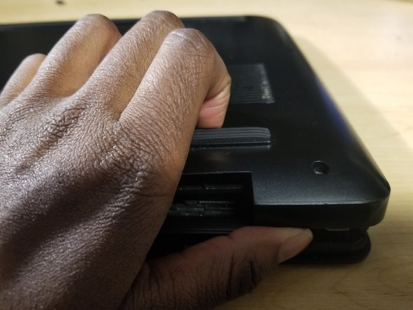

  3. Dell G3 15 3579  RAM Replacement: crwdns2935265:03crwdnd2935265:01crwdnd2935265:03crwdne2935265:0 Dell G3 15 3579  RAM Replacement: crwdns2935265:03crwdnd2935265:02crwdnd2935265:03crwdne2935265:0 Dell G3 15 3579  RAM Replacement: crwdns2935265:03crwdnd2935265:03crwdnd2935265:03crwdne2935265:0
    • Use your hands or an opening tool to gently pry the bottom panel off, starting from the left hinge.
    • Continue prying from the bottom to the right side of the back panel and lift it off.
