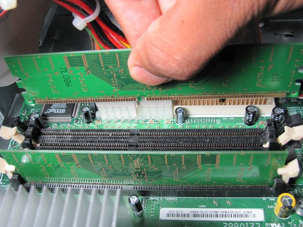

    1. Dell Dimension 4600 RAM Replacement, RAM: crwdns2935265:04crwdnd2935265:01crwdnd2935265:01crwdne2935265:0
      • Lay the computer flat on its side so that you are looking down on all of the components.
      • Locate the RAM modules on the motherboard.
    2. Dell Dimension 4600 RAM Replacement: crwdns2935265:05crwdnd2935265:01crwdnd2935265:02crwdne2935265:0 Dell Dimension 4600 RAM Replacement: crwdns2935265:05crwdnd2935265:02crwdnd2935265:02crwdne2935265:0
      • Locate the white or black tabs holding the RAM module in place.
      • Place your index finger on the tab and firmly press down. The tab should release and the RAM module should be slightly raised.
      • Repeat this for the tab on the other side of the RAM module.
      • Repeat this step for each RAM module.
    3. Dell Dimension 4600 RAM Replacement: crwdns2935265:06crwdnd2935265:01crwdnd2935265:02crwdne2935265:0 Dell Dimension 4600 RAM Replacement: crwdns2935265:06crwdnd2935265:02crwdnd2935265:02crwdne2935265:0
      • Grasp the RAM module and firmly pull upwards until it is released from its slot.
