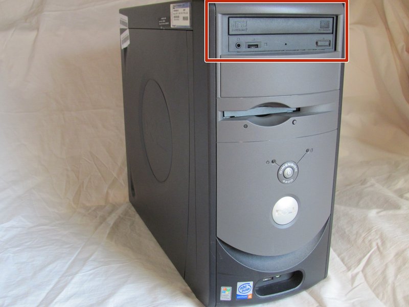

    1. Dell Dimension 4600 Optical Drive Replacement, Optical Drive: crwdns2935265:04crwdnd2935265:01crwdnd2935265:01crwdne2935265:0
      • Locate the Optical Drive by finding it externally on the case.

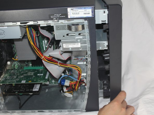

      • Press and hold the three levers located behind the front panel.
      • While holding the levers down, swing open the front panel.
    3. Dell Dimension 4600 Optical Drive Replacement: crwdns2935265:06crwdnd2935265:01crwdnd2935265:01crwdne2935265:0
      • Swing the front of the case open until it separates from the main case.

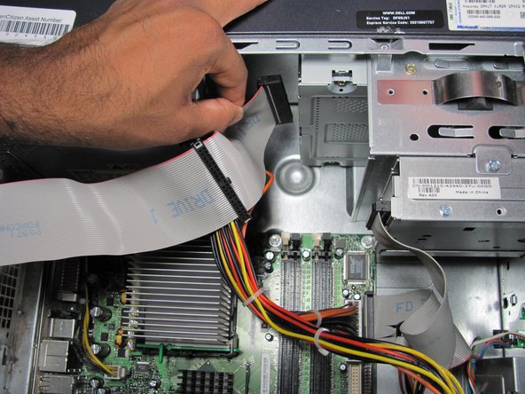

      • Locate the Drive 1 cable and where it is connected to the motherboard.
    5. Dell Dimension 4600 Optical Drive Replacement: crwdns2935265:08crwdnd2935265:01crwdnd2935265:01crwdne2935265:0
      • Grasp the end of the Drive 1 cable connected to the motherboard and firmly pull upwards until it is removed.
    6. Dell Dimension 4600 Optical Drive Replacement: crwdns2935265:09crwdnd2935265:01crwdnd2935265:02crwdne2935265:0 Dell Dimension 4600 Optical Drive Replacement: crwdns2935265:09crwdnd2935265:02crwdnd2935265:02crwdne2935265:0
      • Locate the end of the Drive 1 cable connected to the optical drive.
      • Grasp the cable and pull firmly to disconnect it from the optical drive.

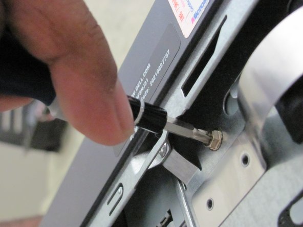

      • Locate the screw on the optical drive.
      • Remove the 7.7 mm screw by using a Phillips #2 screw-driver.
    8. Dell Dimension 4600 Optical Drive Replacement: crwdns2935265:011crwdnd2935265:01crwdnd2935265:01crwdne2935265:0
      • Remove the optical drive by sliding it out of the front of the case.
