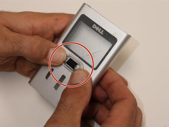

    • Inspect the shell of the device before placing the button pad and center toggle back into the device.
    • Look for cracks in the device's shell and identify whether the device shell is obstructing the button connection.
    • Clean the shell thoroughly using a cotton swab into the creases of the the device shell. Use a water dampened cloth to wipe down the device shell inside and out.
    • The center toggle (circled in red) button snaps into place. Be sure the center button is placed in correctly.
  4. Dell DJ Front Panel Buttons Replacement: crwdns2935265:04crwdnd2935265:01crwdnd2935265:01crwdne2935265:0
    • After the device is assembled, power the device on. The issue with the unresposnive/sticky buttons should be repaired.
    • If the device buttons are still defective, an issue greater than the device button connection is the cause.
