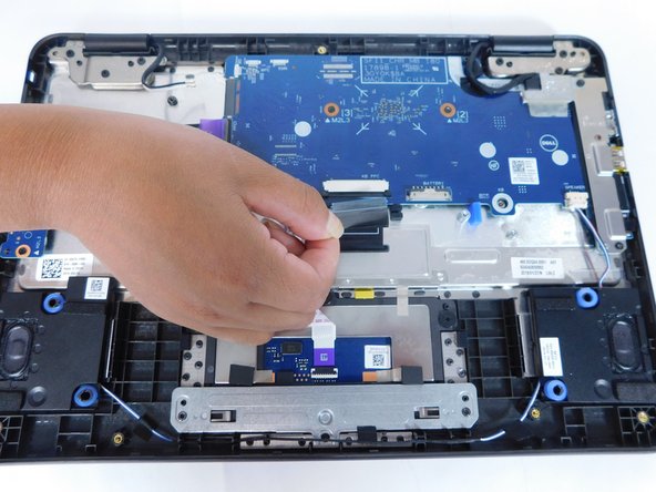

  4. Dell Chromebook 5190 Motherboard Replacement: crwdns2935265:04crwdnd2935265:01crwdnd2935265:02crwdne2935265:0 Dell Chromebook 5190 Motherboard Replacement: crwdns2935265:04crwdnd2935265:02crwdnd2935265:02crwdne2935265:0
    • Remove the clear adhesive tape on the system board from the battery cable from where it's seated above the battery.
    • Pull out the keyboard cable toward you to disconnect it.

  10. Dell Chromebook 5190 Motherboard Replacement: crwdns2935265:010crwdnd2935265:01crwdnd2935265:02crwdne2935265:0 Dell Chromebook 5190 Motherboard Replacement: crwdns2935265:010crwdnd2935265:02crwdnd2935265:02crwdne2935265:0
    • Push downwards on the black tabs located on both side of the motherboard connector.
    • Disconnect the keyboard cable.
