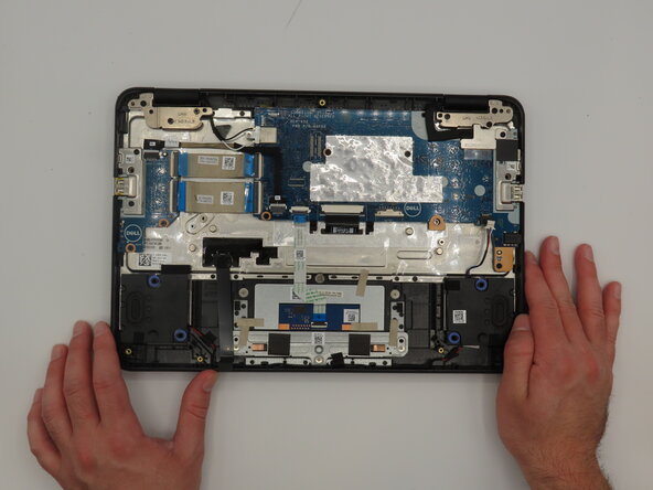

  5. Dell Chromebook 3100 Speakers Replacement, Speakers: crwdns2935265:05crwdnd2935265:01crwdnd2935265:02crwdne2935265:0 Dell Chromebook 3100 Speakers Replacement, Speakers: crwdns2935265:05crwdnd2935265:02crwdnd2935265:02crwdne2935265:0
    • Gently detach the wire connecting the speakers to the motherboard.
  6. Dell Chromebook 3100 Speakers Replacement: crwdns2935265:06crwdnd2935265:01crwdnd2935265:01crwdne2935265:0
    • Lift up and remove the left speaker assembly from the posts.
    • Speakers are secured by two small posts. Simply lift up on the left speaker assembly module.

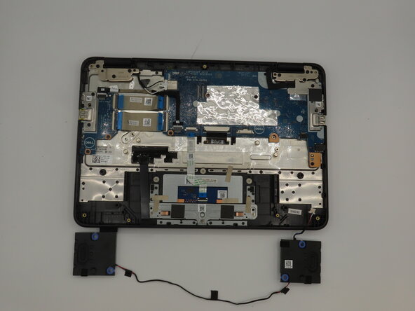

  7. Dell Chromebook 3100 Speakers Replacement: crwdns2935265:07crwdnd2935265:01crwdnd2935265:01crwdne2935265:0
    • Lift up and remove the right speaker module from the posts.
  8. Dell Chromebook 3100 Speakers Replacement: crwdns2935265:08crwdnd2935265:01crwdnd2935265:02crwdne2935265:0 Dell Chromebook 3100 Speakers Replacement: crwdns2935265:08crwdnd2935265:02crwdnd2935265:02crwdne2935265:0
    • Remove the wiring from the wire guides along the bottom portion of the case.
    • Remove the speaker modules and the connected wires from the system.
