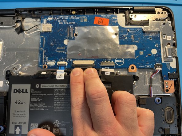

  3. Dell Chromebook 3100 Keyboard Replacement, Disconnect Keyboard Ribbon: crwdns2935265:03crwdnd2935265:01crwdnd2935265:02crwdne2935265:0 Dell Chromebook 3100 Keyboard Replacement, Disconnect Keyboard Ribbon: crwdns2935265:03crwdnd2935265:02crwdnd2935265:02crwdne2935265:0
    • Locate the keyboard ribbon and the two black clips on both sides. NOTE: These clips hold the ribbon in place and slide back and forward.
    • Slide the clips towards the battery to release the ribbon. Lift the ribbon out.

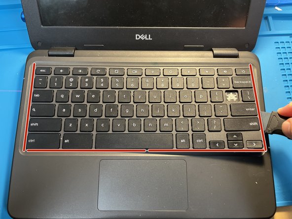

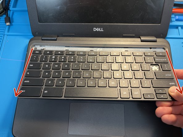

  4. Dell Chromebook 3100 Keyboard Replacement, Remove the Keyboard: crwdns2935265:04crwdnd2935265:01crwdnd2935265:03crwdne2935265:0 Dell Chromebook 3100 Keyboard Replacement, Remove the Keyboard: crwdns2935265:04crwdnd2935265:02crwdnd2935265:03crwdne2935265:0 Dell Chromebook 3100 Keyboard Replacement, Remove the Keyboard: crwdns2935265:04crwdnd2935265:03crwdnd2935265:03crwdne2935265:0
    • Turn the device over. Using your Jimmy, firmly press between the keyboard and the frame to separate it. Repeat this process along both sides and the bottom of the keyboard near the track pad.
    • IMPORTANT: This portion requires a bit of patience and a balance between the right amount of force and prying.
    • Once the three sides have been pried open, lift the keyboard slightly and pull towards you.

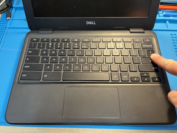

  5. Dell Chromebook 3100 Keyboard Replacement, Replace Keyboard: crwdns2935265:05crwdnd2935265:01crwdnd2935265:03crwdne2935265:0 Dell Chromebook 3100 Keyboard Replacement, Replace Keyboard: crwdns2935265:05crwdnd2935265:02crwdnd2935265:03crwdne2935265:0 Dell Chromebook 3100 Keyboard Replacement, Replace Keyboard: crwdns2935265:05crwdnd2935265:03crwdnd2935265:03crwdne2935265:0
    • Line up the tabs on the keyboard with the frame and slide it forward.
    • Before setting the keyboard down, feed the ribbon through the slot in the frame.
    • Press firmly on all side of the keyboard to snap it into place. NOTE: There are several connectors between the keys that also need to pressed into place.
  6. Dell Chromebook 3100 Keyboard Replacement, Connect Keyboard Ribbon: crwdns2935265:06crwdnd2935265:01crwdnd2935265:01crwdne2935265:0
    • Flip the device over. take the ribbon and insert it back into the main board slot.
    • Slide the clips forward to secure the ribbon.
