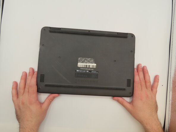

    • Flip the laptop so the bottom is facing upwards.

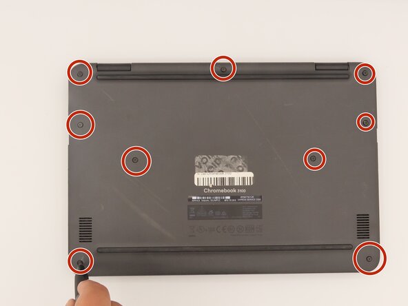

    • Loosen the nine screws from the back panel using a Phillips #0 screwdriver.
  2. Dell Chromebook 3100 IO Board Replacement: crwdns2935265:02crwdnd2935265:01crwdnd2935265:01crwdne2935265:0
    • Pry the back panel away from the rest of the laptop using an iFixit opening tool.

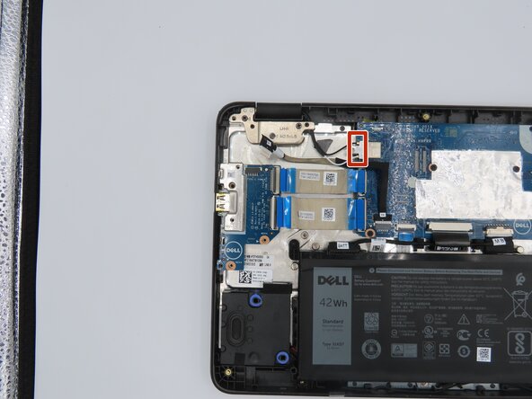

  3. Dell Chromebook 3100 IO Board Replacement, Battery: crwdns2935265:03crwdnd2935265:01crwdnd2935265:02crwdne2935265:0 Dell Chromebook 3100 IO Board Replacement, Battery: crwdns2935265:03crwdnd2935265:02crwdnd2935265:02crwdne2935265:0

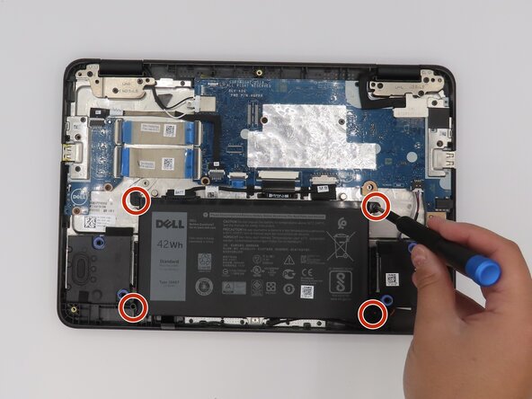

    • Remove the screws attached to the battery using a Phillips #0 screwdriver.
    • Disconnect the battery from the motherboard by gently pulling on the connector cable at the top of the battery.

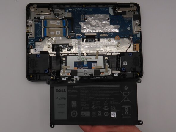

  4. Dell Chromebook 3100 IO Board Replacement: crwdns2935265:04crwdnd2935265:01crwdnd2935265:01crwdne2935265:0
    • Carefully remove the battery.

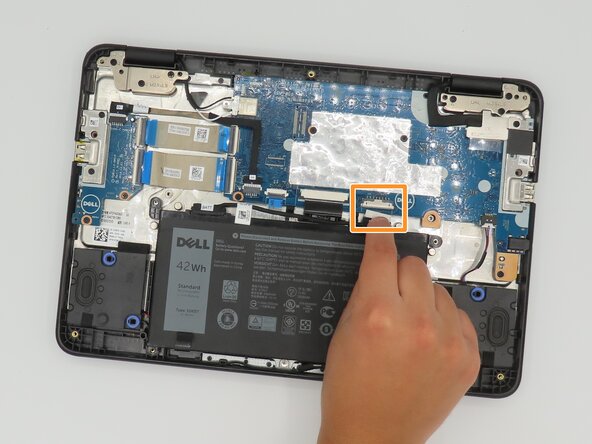

  5. Dell Chromebook 3100 IO Board Replacement, IO Board: crwdns2935265:05crwdnd2935265:01crwdnd2935265:01crwdne2935265:0
    • Remove the screws from the IO Board using a Phillips #0 screwdriver.
    • Carefully disconnect the IO power cable labeled with "IO" and "MB."
