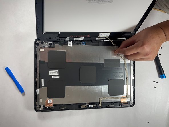

  13. Dell Chromebook 3100 2-in-1 Display Replacement: crwdns2935265:013crwdnd2935265:01crwdnd2935265:02crwdne2935265:0 Dell Chromebook 3100 2-in-1 Display Replacement: crwdns2935265:013crwdnd2935265:02crwdnd2935265:02crwdne2935265:0
    • Peel back the adhesive tape securing the display cable on the back of the display panel and separate the display.
