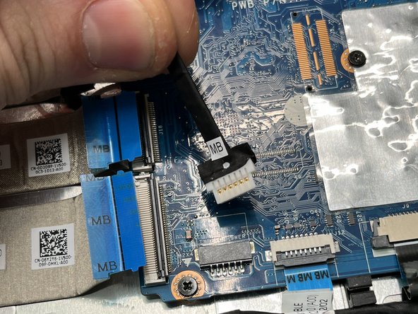

  2. Dell Chromebook 3100 (Touch) Motherboard Replacement, Motherboard: crwdns2935265:02crwdnd2935265:01crwdnd2935265:02crwdne2935265:0 Dell Chromebook 3100 (Touch) Motherboard Replacement, Motherboard: crwdns2935265:02crwdnd2935265:02crwdnd2935265:02crwdne2935265:0
    • Disconnect the daughterboard data cables.
  3. Dell Chromebook 3100 (Touch) Motherboard Replacement: crwdns2935265:03crwdnd2935265:01crwdnd2935265:02crwdne2935265:0 Dell Chromebook 3100 (Touch) Motherboard Replacement: crwdns2935265:03crwdnd2935265:02crwdnd2935265:02crwdne2935265:0
    • Pull the daughterboard power cable out of its socket parallel to the motherboard.

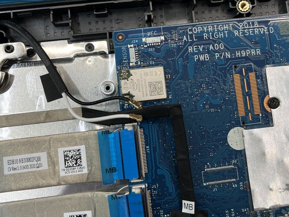

  4. Dell Chromebook 3100 (Touch) Motherboard Replacement: crwdns2935265:04crwdnd2935265:01crwdnd2935265:02crwdne2935265:0 Dell Chromebook 3100 (Touch) Motherboard Replacement: crwdns2935265:04crwdnd2935265:02crwdnd2935265:02crwdne2935265:0
    • Remove the M2x3 screw and cover, and disconnect the antenna cables.
    • Note: be careful on reassembly. Antenna connectors can be troublesome and are easy to damage.

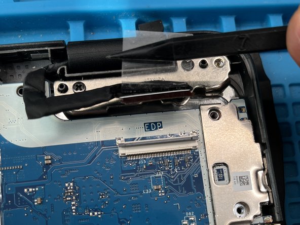

    • Remove the four M2x4 screws, as well as the cover over the LVDS cable (top right).
  7. Dell Chromebook 3100 (Touch) Motherboard Replacement: crwdns2935265:07crwdnd2935265:01crwdnd2935265:02crwdne2935265:0 Dell Chromebook 3100 (Touch) Motherboard Replacement: crwdns2935265:07crwdnd2935265:02crwdnd2935265:02crwdne2935265:0
    • Detach the LVDS cable.
    • The cable is held down with adhesive. Don't be shy about pulling it off the motherboard.

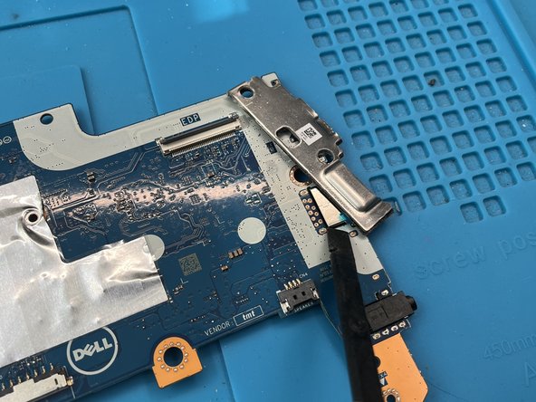

  9. Dell Chromebook 3100 (Touch) Motherboard Replacement: crwdns2935265:09crwdnd2935265:01crwdnd2935265:02crwdne2935265:0 Dell Chromebook 3100 (Touch) Motherboard Replacement: crwdns2935265:09crwdnd2935265:02crwdnd2935265:02crwdne2935265:0
    • Apply lateral force to the IO shield to break the adhesive holding it to the motherboard.
    • Save this IO shield to put on the new motherboard.
