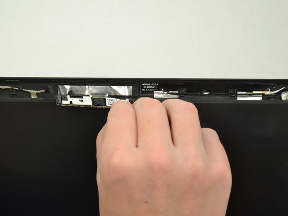

  2. Dell Chromebook 13-7310 Web Camera Replacement: crwdns2935265:02crwdnd2935265:01crwdnd2935265:02crwdne2935265:0 Dell Chromebook 13-7310 Web Camera Replacement: crwdns2935265:02crwdnd2935265:02crwdnd2935265:02crwdne2935265:0
    • Now that the camera is exposed, disconnect the wire by hand to untether the camera unit from the motherboard.
    • To disconnect, pull to the straight back from the camera connection point.
  3. Dell Chromebook 13-7310 Web Camera Replacement: crwdns2935265:03crwdnd2935265:01crwdnd2935265:02crwdne2935265:0 Dell Chromebook 13-7310 Web Camera Replacement: crwdns2935265:03crwdnd2935265:02crwdnd2935265:02crwdne2935265:0
    • Once you have disconnected the camera, use the small nylon pry bar to dislodge the camera assembly from the computer housing.
    • CAUTION The camera assembly is held very securely to an thin alloy backing plate. Pry slowly and gently as to not damage the backing plate when removing.
    • After the camera assembly is free from the backing plate, remove it from the housing bay hand.
