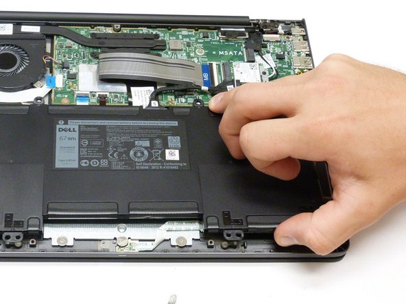

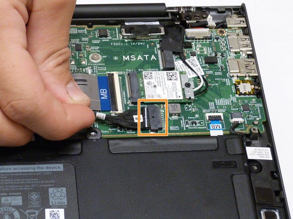

    • The battery must be removed to access the mouse pad. To remove the battery, undo the two, 2mm screws located on each side.
    • Once all four screws are removed, unplug the battery connection cable by hand to disconnect the battery from the motherboard.
    • To remove the battery, lift up on one side to get you fingers underneath and lift away.

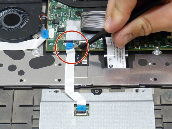

  4. Dell Chromebook 13-7310 Mousepad Replacement: crwdns2935265:04crwdnd2935265:01crwdnd2935265:03crwdne2935265:0 Dell Chromebook 13-7310 Mousepad Replacement: crwdns2935265:04crwdnd2935265:02crwdnd2935265:03crwdne2935265:0 Dell Chromebook 13-7310 Mousepad Replacement: crwdns2935265:04crwdnd2935265:03crwdnd2935265:03crwdne2935265:0
    • Remove the six 2mm screws located around the maouse pad cover.
    • Using either fingernails or tweezers, lift the black cover on the ribbon cable and pull the cable loose from he motherboard.
    • Once the ribbon cable is disconnected lift up on the back cove to remove it and expose the mouse pad.

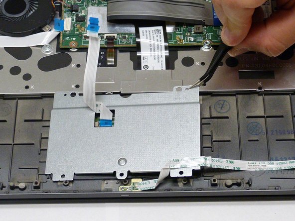

  5. Dell Chromebook 13-7310 Mousepad Replacement: crwdns2935265:05crwdnd2935265:01crwdnd2935265:01crwdne2935265:0
    • Now that the mouse pad is exposed, lift the assembly to remove the mouse pad.
