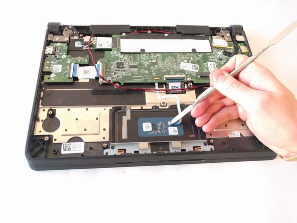

  3. Dell Chromebook 11-3120 Track Pad Replacement, Track Pad: crwdns2935265:03crwdnd2935265:01crwdnd2935265:03crwdne2935265:0 Dell Chromebook 11-3120 Track Pad Replacement, Track Pad: crwdns2935265:03crwdnd2935265:02crwdnd2935265:03crwdne2935265:0 Dell Chromebook 11-3120 Track Pad Replacement, Track Pad: crwdns2935265:03crwdnd2935265:03crwdnd2935265:03crwdne2935265:0
    • Using a pointed metal spudger, pull the tiny switch on top of the ribbon cable port away from the wire insertion to unlock it. Then gently remove the ribbon cable that connects the trackpad to the motherboard.
    • Use caution when removing ribbon cables as they may tear if too much force is applied.
    • Make sure the switch is lifted before pulling out the ribbon cable. Failure to do so can damage the locking mechanism.
