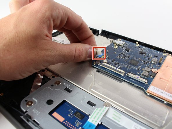

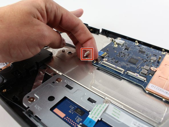

  6. Dell Chromebook 11 3180 Speakers Replacement, Speakers: crwdns2935265:06crwdnd2935265:01crwdnd2935265:03crwdne2935265:0 Dell Chromebook 11 3180 Speakers Replacement, Speakers: crwdns2935265:06crwdnd2935265:02crwdnd2935265:03crwdne2935265:0 Dell Chromebook 11 3180 Speakers Replacement, Speakers: crwdns2935265:06crwdnd2935265:03crwdnd2935265:03crwdne2935265:0
    • Locate and gently pull the wire harness (small plastic box with wires leading to black audio speakers) directly out of the connector on the motherboard.
    • Some components are not shown in pictures for simplicity. There is no need to remove any of the missing components to successfully remove the speakers.

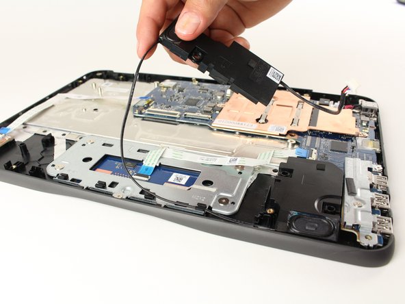

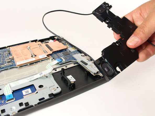

  7. Dell Chromebook 11 3180 Speakers Replacement: crwdns2935265:07crwdnd2935265:01crwdnd2935265:03crwdne2935265:0 Dell Chromebook 11 3180 Speakers Replacement: crwdns2935265:07crwdnd2935265:02crwdnd2935265:03crwdne2935265:0 Dell Chromebook 11 3180 Speakers Replacement: crwdns2935265:07crwdnd2935265:03crwdnd2935265:03crwdne2935265:0
    • Remove any existing tape attached to the audio wire you unplugged in the previous step.
    • Gently lift and remove speakers.
    • No screws should be removed
