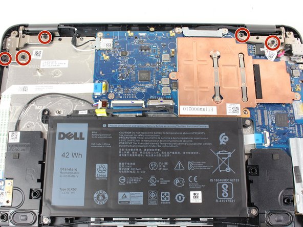

  6. Dell Chromebook 11 3180 Screen Replacement, Screen: crwdns2935265:06crwdnd2935265:01crwdnd2935265:03crwdne2935265:0 Dell Chromebook 11 3180 Screen Replacement, Screen: crwdns2935265:06crwdnd2935265:02crwdnd2935265:03crwdne2935265:0 Dell Chromebook 11 3180 Screen Replacement, Screen: crwdns2935265:06crwdnd2935265:03crwdnd2935265:03crwdne2935265:0
    • Using a Phillips #0 screwdriver, remove each of the five 5.5mm screws.

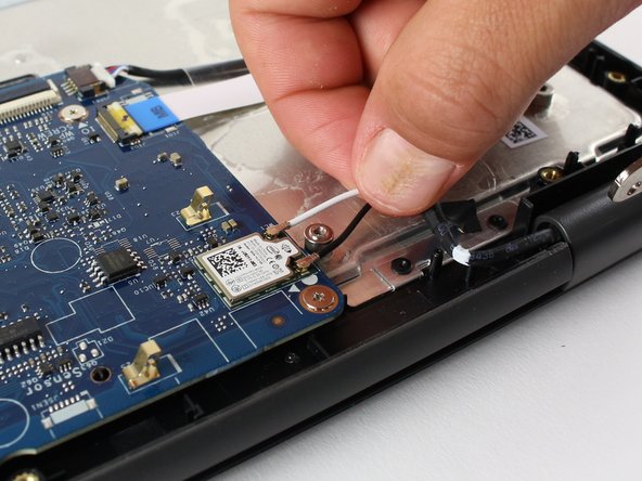

  7. Dell Chromebook 11 3180 Screen Replacement: crwdns2935265:07crwdnd2935265:01crwdnd2935265:02crwdne2935265:0 Dell Chromebook 11 3180 Screen Replacement: crwdns2935265:07crwdnd2935265:02crwdnd2935265:02crwdne2935265:0
    • Using a Phillips #0 screwdriver, remove the single 3mm Phillips head screw holding down the small metal bracket that covers where the small black and white wires connect to the motherboard.
    • Once this screw has been removed. Unplug these two wires by gently puling them up and away from the motherboard. Hold the wire as close to the end as possible.

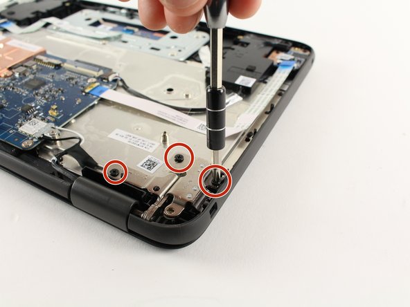

  8. Dell Chromebook 11 3180 Screen Replacement: crwdns2935265:08crwdnd2935265:01crwdnd2935265:01crwdne2935265:0
    • Using a Phillips #0 screwdriver, remove the two 3mm Phillips head screws from the metal bracket that covers where the wrapped cable from the screen attaches to the motherboard.

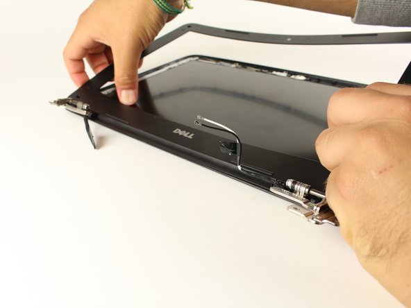

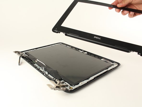

  12. Dell Chromebook 11 3180 Screen Replacement: crwdns2935265:012crwdnd2935265:01crwdnd2935265:03crwdne2935265:0 Dell Chromebook 11 3180 Screen Replacement: crwdns2935265:012crwdnd2935265:02crwdnd2935265:03crwdne2935265:0 Dell Chromebook 11 3180 Screen Replacement: crwdns2935265:012crwdnd2935265:03crwdnd2935265:03crwdne2935265:0
    • Using a plastic opening tool to start, and then eventually your hands, pry the front most face of plastic off of the screen assembly.

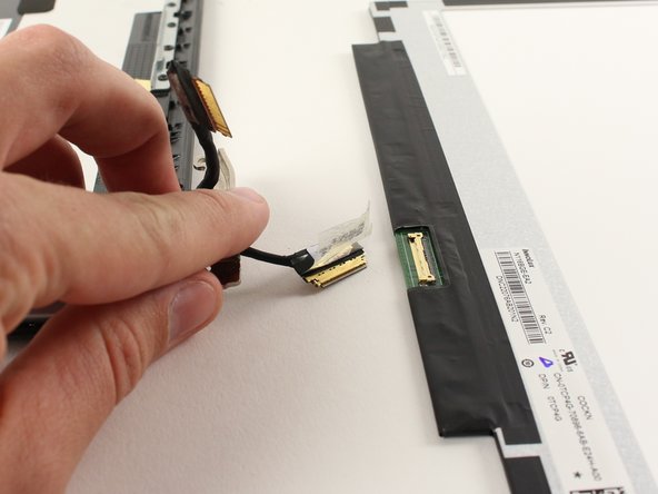

  15. Dell Chromebook 11 3180 Screen Replacement: crwdns2935265:015crwdnd2935265:01crwdnd2935265:02crwdne2935265:0 Dell Chromebook 11 3180 Screen Replacement: crwdns2935265:015crwdnd2935265:02crwdnd2935265:02crwdne2935265:0
    • To unplug the screen, use tweezers to lift the small metal wire on the connector, and then gently pull the cable away from the screen.

You don’t have to disconnect the display from the main body. Just be careful cause the plastic lcd bezel has strong adhesive and it is easy to crack the plastic bezel when separating it from the LCD panel.
