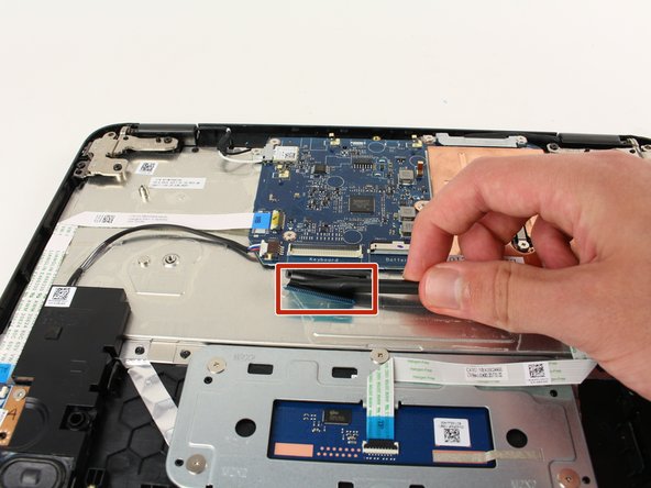

  9. Dell Chromebook 11 3180 Motherboard  Replacement, Motherboard: crwdns2935265:09crwdnd2935265:01crwdnd2935265:03crwdne2935265:0 Dell Chromebook 11 3180 Motherboard  Replacement, Motherboard: crwdns2935265:09crwdnd2935265:02crwdnd2935265:03crwdne2935265:0 Dell Chromebook 11 3180 Motherboard  Replacement, Motherboard: crwdns2935265:09crwdnd2935265:03crwdnd2935265:03crwdne2935265:0

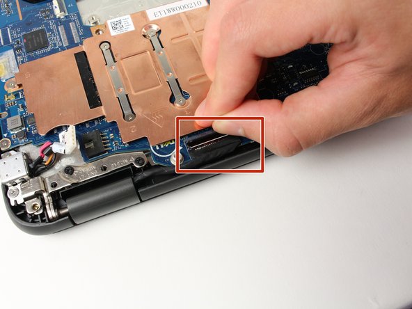

    • Lift the black clasp and gently pull on blue ribbon until it completely disconnects from the motherboard.

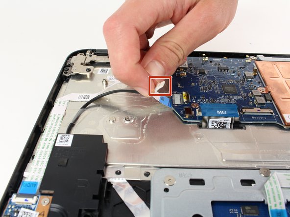

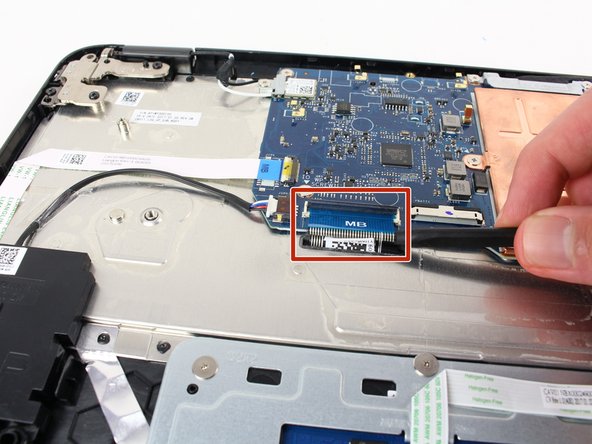

  10. Dell Chromebook 11 3180 Motherboard  Replacement: crwdns2935265:010crwdnd2935265:01crwdnd2935265:03crwdne2935265:0 Dell Chromebook 11 3180 Motherboard  Replacement: crwdns2935265:010crwdnd2935265:02crwdnd2935265:03crwdne2935265:0 Dell Chromebook 11 3180 Motherboard  Replacement: crwdns2935265:010crwdnd2935265:03crwdnd2935265:03crwdne2935265:0
    • Lift the black clasp and use the spudger tool to remove the ribbon so that it completely disconnects from the motherboard.

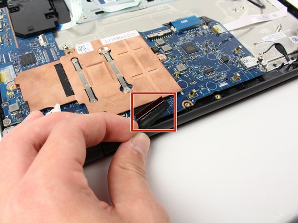

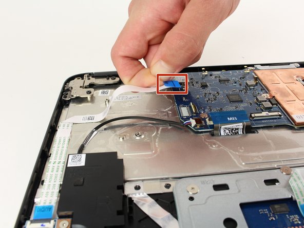

  11. Dell Chromebook 11 3180 Motherboard  Replacement: crwdns2935265:011crwdnd2935265:01crwdnd2935265:02crwdne2935265:0 Dell Chromebook 11 3180 Motherboard  Replacement: crwdns2935265:011crwdnd2935265:02crwdnd2935265:02crwdne2935265:0
  12. Dell Chromebook 11 3180 Motherboard  Replacement: crwdns2935265:012crwdnd2935265:01crwdnd2935265:02crwdne2935265:0 Dell Chromebook 11 3180 Motherboard  Replacement: crwdns2935265:012crwdnd2935265:02crwdnd2935265:02crwdne2935265:0

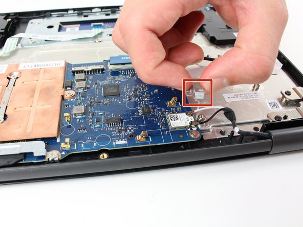

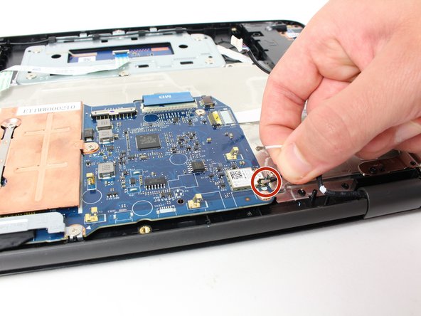

  13. Dell Chromebook 11 3180 Motherboard  Replacement: crwdns2935265:013crwdnd2935265:01crwdnd2935265:03crwdne2935265:0 Dell Chromebook 11 3180 Motherboard  Replacement: crwdns2935265:013crwdnd2935265:02crwdnd2935265:03crwdne2935265:0 Dell Chromebook 11 3180 Motherboard  Replacement: crwdns2935265:013crwdnd2935265:03crwdnd2935265:03crwdne2935265:0
    • Using a Phillips #0 screwdriver, remove the single 3mm screw.
    • Remove the metal shield protecting the black and white wires beneath it.

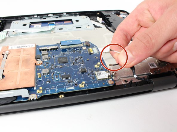

  14. Dell Chromebook 11 3180 Motherboard  Replacement: crwdns2935265:014crwdnd2935265:01crwdnd2935265:03crwdne2935265:0 Dell Chromebook 11 3180 Motherboard  Replacement: crwdns2935265:014crwdnd2935265:02crwdnd2935265:03crwdne2935265:0 Dell Chromebook 11 3180 Motherboard  Replacement: crwdns2935265:014crwdnd2935265:03crwdnd2935265:03crwdne2935265:0
    • Locate and gently pull up on the white and black wires to disconnect them from the motherboard.

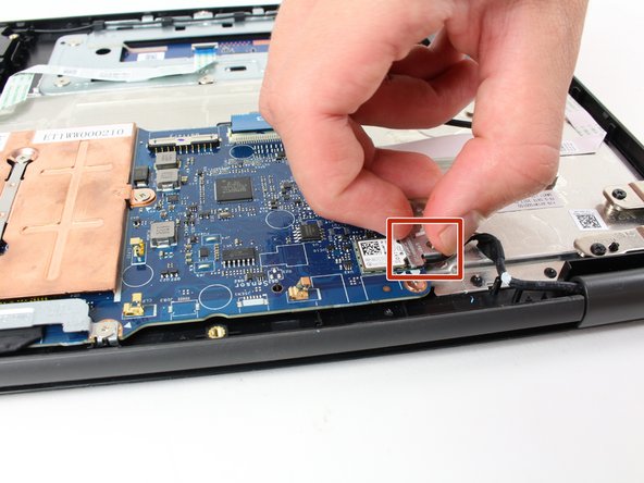

  15. Dell Chromebook 11 3180 Motherboard  Replacement: crwdns2935265:015crwdnd2935265:01crwdnd2935265:03crwdne2935265:0 Dell Chromebook 11 3180 Motherboard  Replacement: crwdns2935265:015crwdnd2935265:02crwdnd2935265:03crwdne2935265:0 Dell Chromebook 11 3180 Motherboard  Replacement: crwdns2935265:015crwdnd2935265:03crwdnd2935265:03crwdne2935265:0
    • Locate and gently pull the wire harness (small plastic box with two pink, one orange, and two black wires) directly out of the connector on the motherboard.
