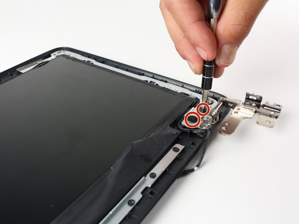

  16. Dell Chromebook 11 3180 Display Hinges Replacement, Display Hinges: crwdns2935265:016crwdnd2935265:01crwdnd2935265:02crwdne2935265:0 Dell Chromebook 11 3180 Display Hinges Replacement, Display Hinges: crwdns2935265:016crwdnd2935265:02crwdnd2935265:02crwdne2935265:0
    • Using a Phillips #0 screwdriver, remove all four of 2.5mm Phillips head screws from the silver metal bracket.
    • Though the picture shows this step with the screen still in, you should remove the screen first and then remove this bracket.
  17. Dell Chromebook 11 3180 Display Hinges Replacement: crwdns2935265:017crwdnd2935265:01crwdnd2935265:02crwdne2935265:0 Dell Chromebook 11 3180 Display Hinges Replacement: crwdns2935265:017crwdnd2935265:02crwdnd2935265:02crwdne2935265:0
    • Once the screws have been removed, use a plastic opening tool to pry the metal bracket and hinge assembly off of the plastic backing.
