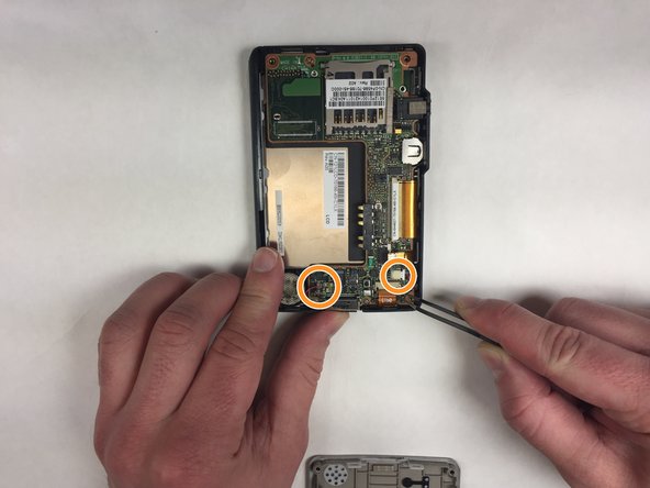

    • Disconnect ribbon cables.
    • You may need to use a little force to disconnect them.
    • Disconnect red and white wired connector for speaker and motherboard battery.

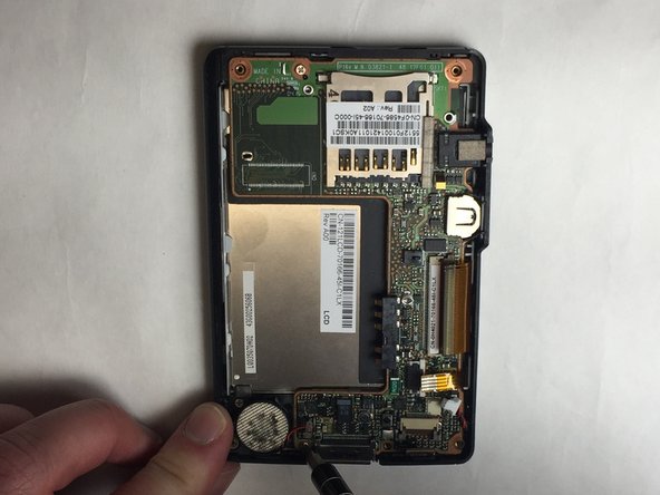

    • Remove three 12.7mm JIS #0 screws.
  7. Dell Axim X30 Screen Replacement: crwdns2935265:07crwdnd2935265:01crwdnd2935265:01crwdne2935265:0

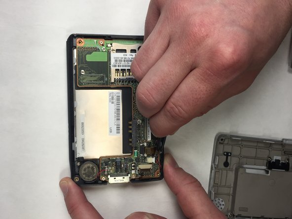

    • Carefully remove motherboard.

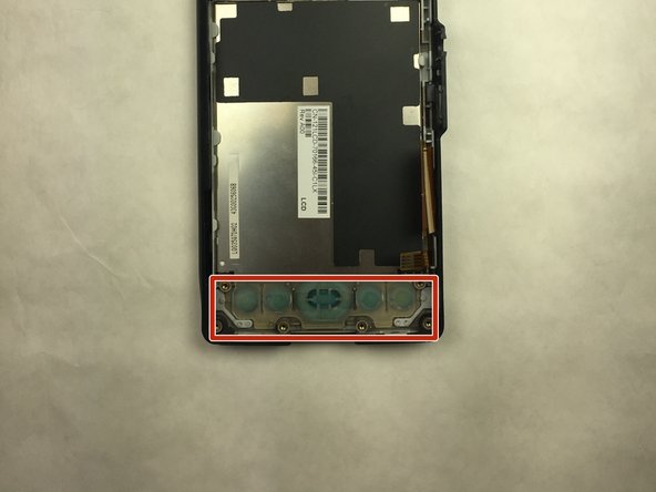

    • Remove black plastic board.
  10. Dell Axim X30 Screen Replacement: crwdns2935265:010crwdnd2935265:01crwdnd2935265:02crwdne2935265:0 Dell Axim X30 Screen Replacement: crwdns2935265:010crwdnd2935265:02crwdnd2935265:02crwdne2935265:0

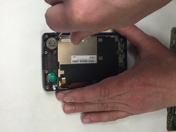

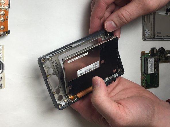

    • Gently apply pressure on the right plastic frame by plastic clip marked on the picture.
    • Apply pressure to the bottom of the screen and press it towards you.
    • Remove screen from plastic case.
