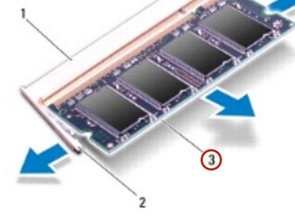

  1. Dell Alienware M18x Memory Modules Replacement, Popping up the Memory Module: crwdns2935265:01crwdnd2935265:01crwdnd2935265:03crwdne2935265:0 Dell Alienware M18x Memory Modules Replacement, Popping up the Memory Module: crwdns2935265:01crwdnd2935265:02crwdnd2935265:03crwdne2935265:0 Dell Alienware M18x Memory Modules Replacement, Popping up the Memory Module: crwdns2935265:01crwdnd2935265:03crwdnd2935265:03crwdne2935265:0
    • Follow the instructions in Before You Begin.
    • CAUTION: To prevent damage to the memory -module connector, do not use tools to spread the memory module securing clips.
    • Using your fingertips, spread apart the securing clips on each end of the memory-module connector until the memory module pops up.
