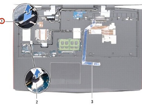

    • Using the pull-tab, pull the display cable to disconnect the display cable from the connector on the system board.
  2. Dell Alienware M18x Display Assembly Replacement, Disconnecting the Video-Card Connector Cable: crwdns2935265:02crwdnd2935265:01crwdnd2935265:01crwdne2935265:0
    • Disconnect and peel off the video-card connector cable from the connector on the system board.
  3. Dell Alienware M18x Display Assembly Replacement, Disconnecting the LED-Logo Board Cable: crwdns2935265:03crwdnd2935265:01crwdnd2935265:02crwdne2935265:0 Dell Alienware M18x Display Assembly Replacement, Disconnecting the LED-Logo Board Cable: crwdns2935265:03crwdnd2935265:02crwdnd2935265:02crwdne2935265:0
    • Disconnect the LED-logo board cable from the connector on the system board.
