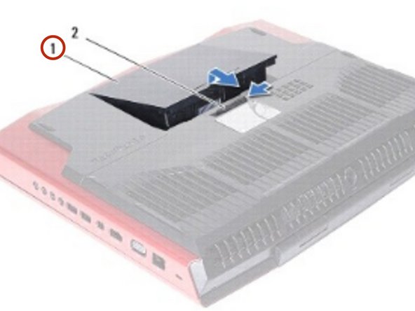

  2. Dell Alienware M18x Battery Pack Replacement, Popping up the Battery Pack: crwdns2935265:02crwdnd2935265:01crwdnd2935265:02crwdne2935265:0 Dell Alienware M18x Battery Pack Replacement, Popping up the Battery Pack: crwdns2935265:02crwdnd2935265:02crwdnd2935265:02crwdne2935265:0
    • Slide the battery latch to the unlock position. The battery pack pops up.

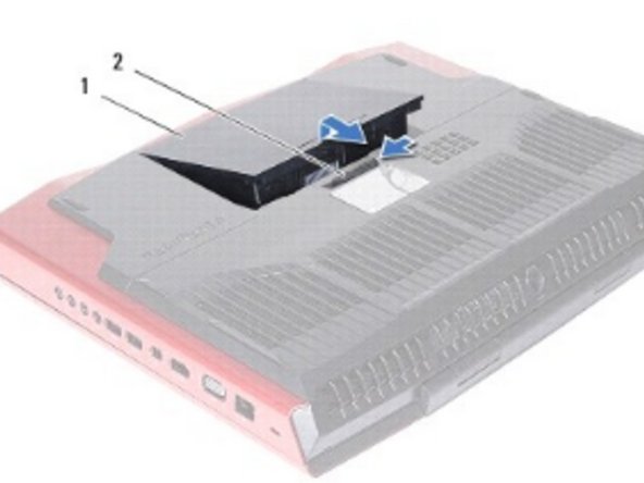

  3. Dell Alienware M18x Battery Pack Replacement, Sliding the Battery Pack: crwdns2935265:03crwdnd2935265:01crwdnd2935265:01crwdne2935265:0
    • Lift and slide the battery pack away from the battery bay.
