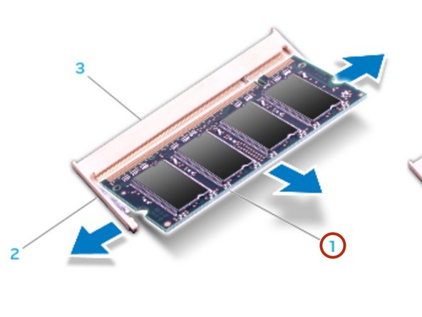

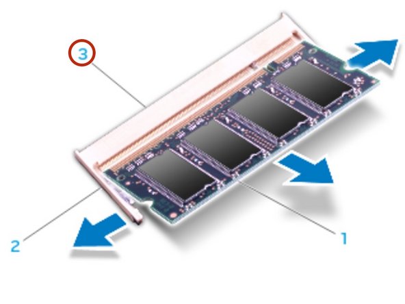

  3. Dell Alienware M17x R2 Memory Modules Replacement, Popping up the Memory Module: crwdns2935265:03crwdnd2935265:01crwdnd2935265:03crwdne2935265:0 Dell Alienware M17x R2 Memory Modules Replacement, Popping up the Memory Module: crwdns2935265:03crwdnd2935265:02crwdnd2935265:03crwdne2935265:0 Dell Alienware M17x R2 Memory Modules Replacement, Popping up the Memory Module: crwdns2935265:03crwdnd2935265:03crwdnd2935265:03crwdne2935265:0
    • CAUTION: If you need to remove memory modules from both connectors, remove the memory module in the upper connector before you remove the module in the lower connector.
    • Use your fingertips to carefully spread apart the spring-locks on the memory module connector until the module pops up.
  4. Dell Alienware M17x R2 Memory Modules Replacement, Removing the Memory Module: crwdns2935265:04crwdnd2935265:01crwdnd2935265:01crwdne2935265:0
    • Remove the memory module.
