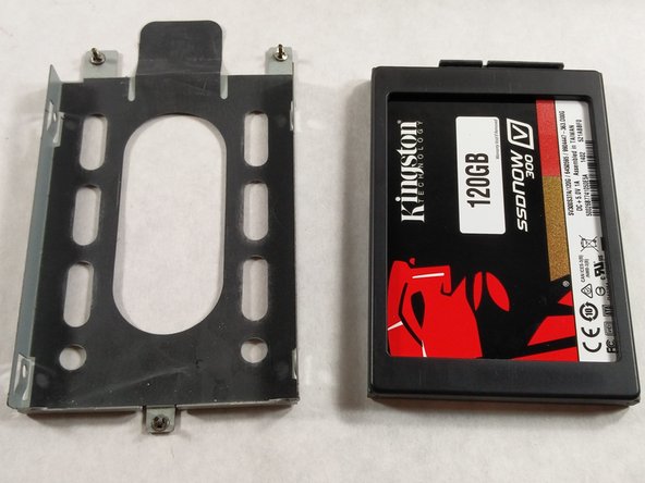

    3. Dell Alienware M11x R3  2.5" Hard Drive Replacement: crwdns2935265:04crwdnd2935265:01crwdnd2935265:02crwdne2935265:0 Dell Alienware M11x R3  2.5" Hard Drive Replacement: crwdns2935265:04crwdnd2935265:02crwdnd2935265:02crwdne2935265:0
      • On both sides of the cage, there are two screws you have to unscrew to be able to remove the SSD.

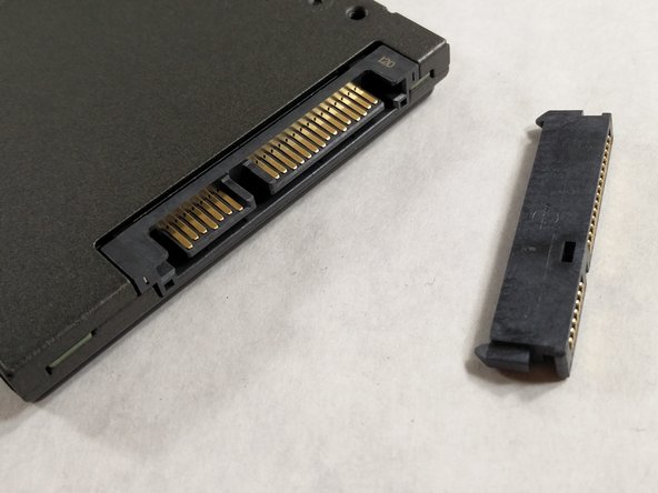

    4. Dell Alienware M11x R3  2.5" Hard Drive Replacement: crwdns2935265:05crwdnd2935265:01crwdnd2935265:02crwdne2935265:0 Dell Alienware M11x R3  2.5" Hard Drive Replacement: crwdns2935265:05crwdnd2935265:02crwdnd2935265:02crwdne2935265:0
      • Finally, remove the L connector for the hard drive. You will need to put this on your new hard drive.
      • Make sure that the SSD you bought to replace this one has the same connections. I.e. able to connect to a SATA cord.
