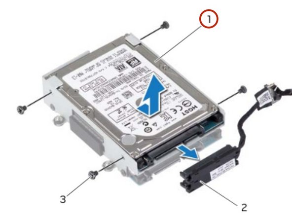

  4. Dell Alienware 18 Hard Drive Replacement, Disconnecting the Interposer: crwdns2935265:04crwdnd2935265:01crwdnd2935265:02crwdne2935265:0 Dell Alienware 18 Hard Drive Replacement, Disconnecting the Interposer: crwdns2935265:04crwdnd2935265:02crwdnd2935265:02crwdne2935265:0
    • Disconnect the interposer from the hard drives.
    • NOTE: Your computer supports up to three drives.
  5. Dell Alienware 18 Hard Drive Replacement, Remove the Screws: crwdns2935265:05crwdnd2935265:01crwdnd2935265:01crwdne2935265:0
    • Remove the screws that secure the hard drive(s) to the hard-drive bracket and slide the hard drive(s) out of the hard-drive bracket.
