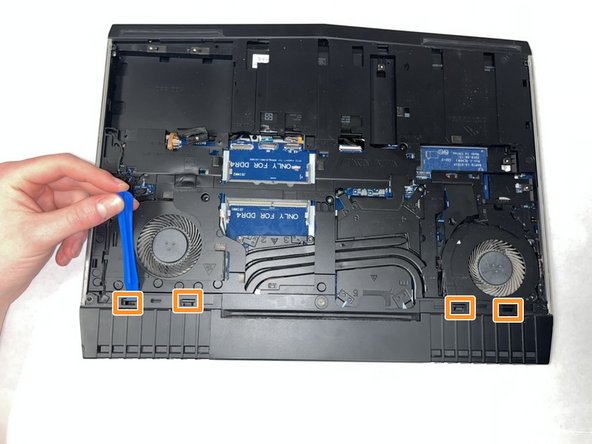

    • Remove the two M2.5x6 screws connecting the rear cover to the computer.
    • Gently pry the rear cover with the iFixit Opening Tool to release the 2 tabs on each side.
    • Slide the rear cover from the computer.

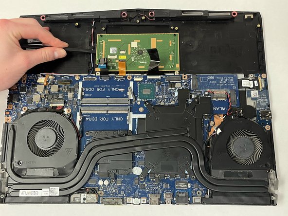

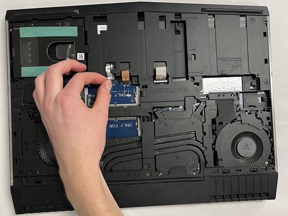

    • Remove the light cable between the hard drive port and fan.
    • Open the latch and remove the keyboard cable. Open the latch and remove the keyboard backlight cable. Open the latch and remove macro keys cable.

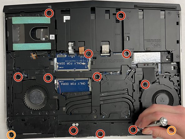

    • Remove the 11 M2.5x8 screws holding the base to the computer.
    • Remove the 2 M2x3 screws.
    • Lift the computer base from the computer. Use the iFixit Opening tool to pry the base off the computer. The base should separate with ease be carful not to break it.

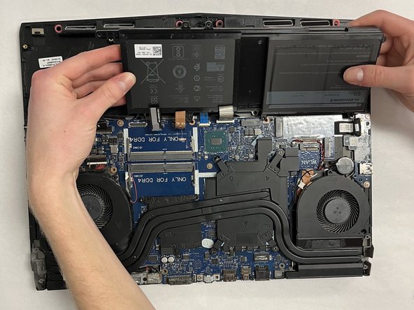

    • Remove the M2.5x5 screw holding the battery to the computer.
    • Remove the battery from the computer.

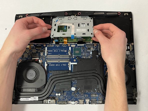

  8. Dell Alienware 15 R3 Touchpad Replacement: crwdns2935265:08crwdnd2935265:01crwdnd2935265:03crwdne2935265:0 Dell Alienware 15 R3 Touchpad Replacement: crwdns2935265:08crwdnd2935265:02crwdnd2935265:03crwdne2935265:0 Dell Alienware 15 R3 Touchpad Replacement: crwdns2935265:08crwdnd2935265:03crwdnd2935265:03crwdne2935265:0
    • Remove five M2x3 screws securing the touchpad bracket to the computer.
    • Lift the touchpad housing from the computer.
    • Gently pry the touchpad to remove adhesive from between touchpad and computer. Lift the touchpad from the computer.
