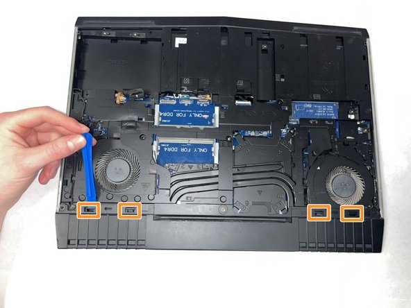

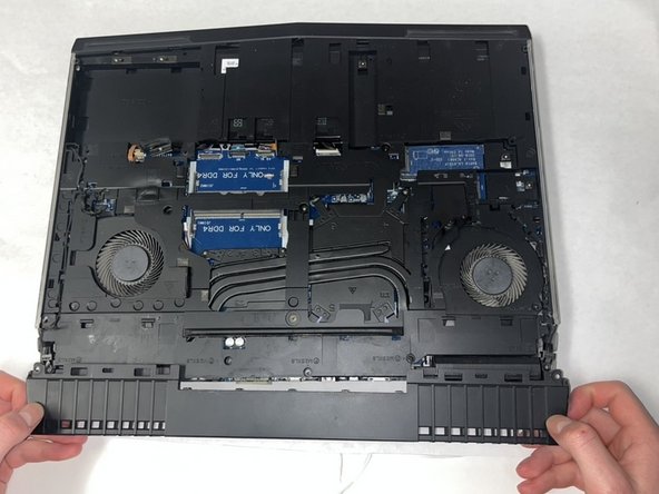

    • Remove the two M2.5x6 screws connecting the rear cover to the computer.
    • Gently pry the rear cover with the iFixit Opening Tool to release the two tabs on each side.
    • Slide the rear cover from the computer.

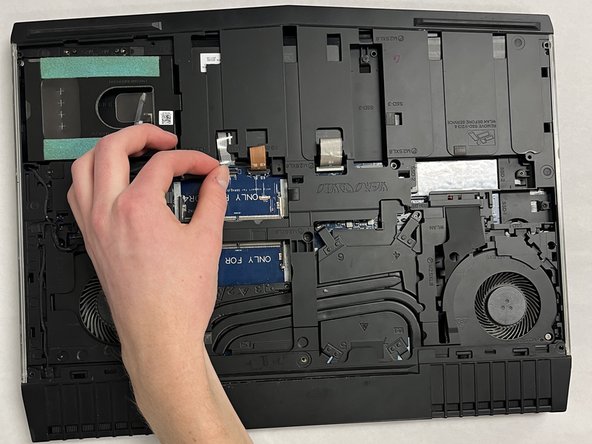

    • Remove the light cable located between hard drive port and fan.
    • Open the latch and remove the keyboard cable, keyboard backlight cable, and the macro keys cable.

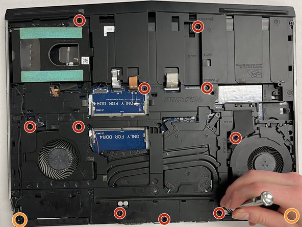

    • Remove the 11 M2.5x8 screws that secure the computer base.
    • Remove the 2 M2x3 screws.
    • Use a pry tool to separate the base from the computer and then lift the computer base from the computer.

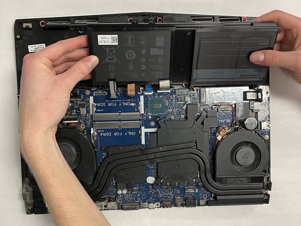

    • Remove the M2.5x5 screw holding the battery to the computer.
    • Remove the battery from the computer.

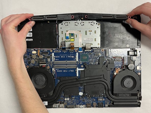

    • Disconnect the speaker cable from the motherboard.
    • Lift the speakers from the computer.
