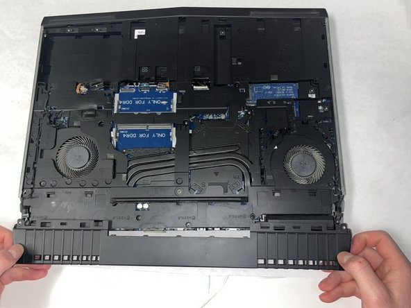

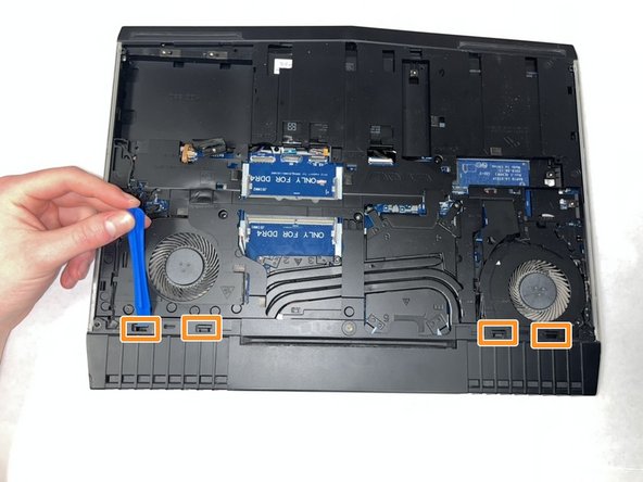

    • Remove the two M2.5x6mm screws connecting the rear cover to the computer.
    • Gently pry the rear cover with the iFixit Opening Tool to release the tabs 2 tabs on each side.
    • Slide the rear cover off of the computer.

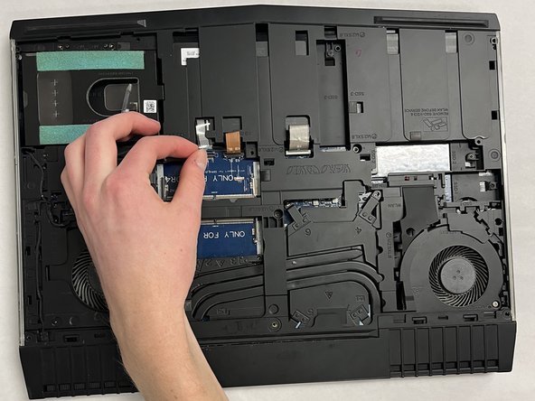

    • Remove light cable between the hard drive port and the fan.
    • Lift the latches and remove the keyboard cable, keyboard backlight cable, and the macro keys cable.

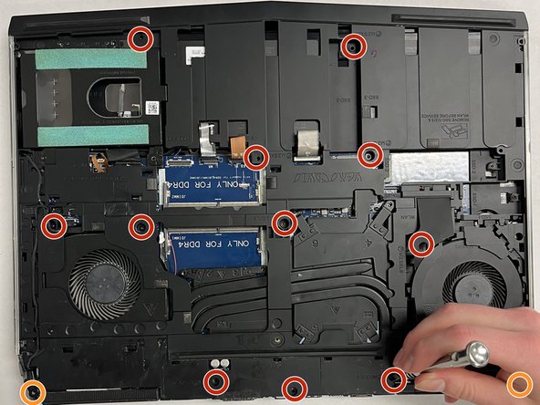

    • Remove the 11 M2.5x8mm screws that secure the computer base.
    • Remove the 2 M2x3mm screws.
    • Lift the computer base from the computer. Use the iFixit Opening tool to pry the base off the computer. Should separate with ease be carful not to break it.

WARNING: This guide is missing many, many steps. You will have to completely remove the motherboard to disconnect the fan power cables. You will also need to clean the CPU and GPU and apply new thermal paste.
William Geraghty - crwdns2934203:0crwdne2934203:0
Also had to remove any NVMe drives to get the full backplate off and the HDD just to remove the weight from the backplate before prying it off.
