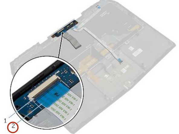

  35. Dell Alienware 13 Wireless Card Replacement, Disconnecting the Power-Board Cable: crwdns2935265:042crwdnd2935265:01crwdnd2935265:02crwdne2935265:0 Dell Alienware 13 Wireless Card Replacement, Disconnecting the Power-Board Cable: crwdns2935265:042crwdnd2935265:02crwdnd2935265:02crwdne2935265:0
    • Lift the connector latch and disconnect the power-button board cable from the power-button board.

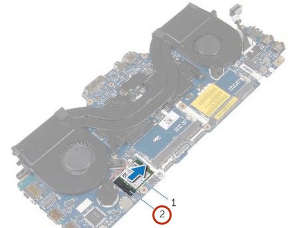

  41. Dell Alienware 13 Wireless Card Replacement, Sliding the Wireless Card: crwdns2935265:048crwdnd2935265:01crwdnd2935265:02crwdne2935265:0 Dell Alienware 13 Wireless Card Replacement, Sliding the Wireless Card: crwdns2935265:048crwdnd2935265:02crwdnd2935265:02crwdne2935265:0
  42. Dell Alienware 13 Wireless Card Replacement, Sliding the NEW Wireless Card: crwdns2935265:049crwdnd2935265:01crwdnd2935265:01crwdne2935265:0
    • Slide the wireless NEW card into the wireless-card slot on the system board.
