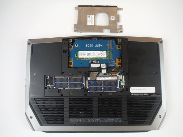

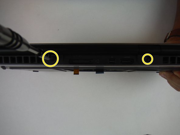

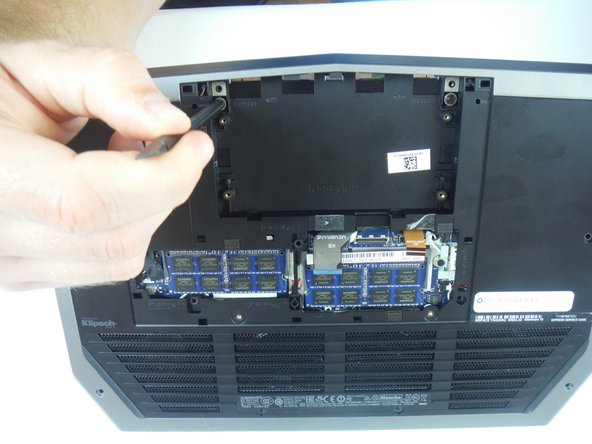

  2. Dell Alienware 13 Touch pad Replacement: crwdns2935265:02crwdnd2935265:01crwdnd2935265:01crwdne2935265:0
    • Remove (2) 5 mm Phillips head screws attaching the small access panel to the base using a Phillips # 1 screwdriver.
    • The (2) screws are attached to the base panel with retaining clips and won't completely detach from the panel.
  3. Dell Alienware 13 Touch pad Replacement: crwdns2935265:03crwdnd2935265:01crwdnd2935265:03crwdne2935265:0 Dell Alienware 13 Touch pad Replacement: crwdns2935265:03crwdnd2935265:02crwdnd2935265:03crwdne2935265:0 Dell Alienware 13 Touch pad Replacement: crwdns2935265:03crwdnd2935265:03crwdnd2935265:03crwdne2935265:0
    Heavy-Duty Spudger

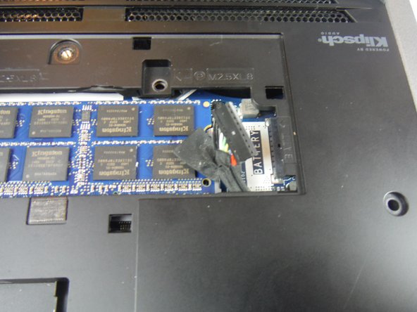

  4. Dell Alienware 13 Touch pad Replacement, Touch pad: crwdns2935265:04crwdnd2935265:01crwdnd2935265:02crwdne2935265:0 Dell Alienware 13 Touch pad Replacement, Touch pad: crwdns2935265:04crwdnd2935265:02crwdnd2935265:02crwdne2935265:0
    • Disconnect the battery cable from the battery cable terminal.

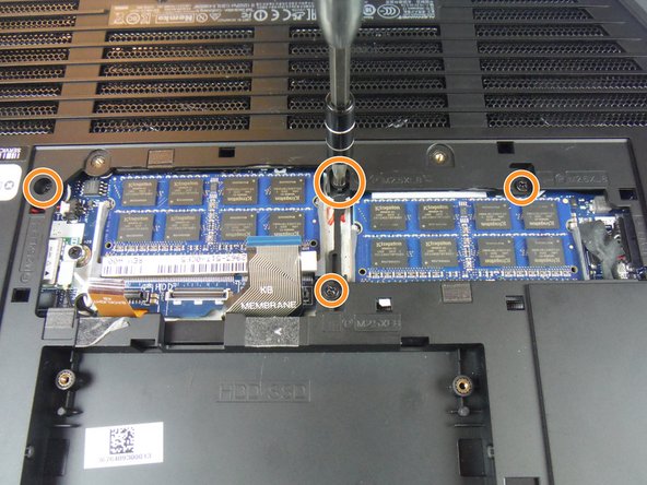

  5. Dell Alienware 13 Touch pad Replacement: crwdns2935265:05crwdnd2935265:01crwdnd2935265:01crwdne2935265:0
    • Remove (4) 6 mm Phillips head screws from the solid-state metal drive bracket, using a Phillips # 1 screwdriver.
  6. Dell Alienware 13 Touch pad Replacement: crwdns2935265:06crwdnd2935265:01crwdnd2935265:02crwdne2935265:0 Dell Alienware 13 Touch pad Replacement: crwdns2935265:06crwdnd2935265:02crwdnd2935265:02crwdne2935265:0
    • Grab the pull tab to pivot the solid-state drive bracket upwards. Remove the bracket from the computer base.

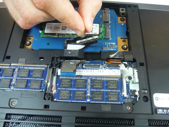

    • Using the pull tab, disconnect the black solid-state drive cable from the system board.
  8. Dell Alienware 13 Touch pad Replacement: crwdns2935265:08crwdnd2935265:01crwdnd2935265:01crwdne2935265:0

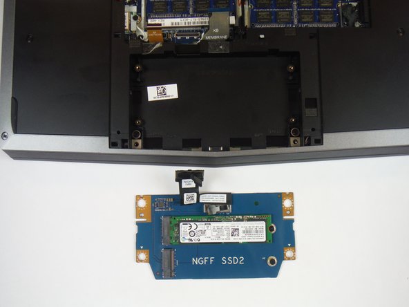

    • Remove (2) 3 mm Phillips head screws, using a Phillips # 0 screwdriver, that connect the solid-state drive assembly to the computer base.
  9. Dell Alienware 13 Touch pad Replacement: crwdns2935265:09crwdnd2935265:01crwdnd2935265:02crwdne2935265:0 Dell Alienware 13 Touch pad Replacement: crwdns2935265:09crwdnd2935265:02crwdnd2935265:02crwdne2935265:0
    • Lift up on the solid-state drive assembly to remove it from the computer base.

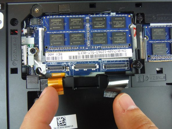

  10. Dell Alienware 13 Touch pad Replacement: crwdns2935265:010crwdnd2935265:01crwdnd2935265:02crwdne2935265:0 Dell Alienware 13 Touch pad Replacement: crwdns2935265:010crwdnd2935265:02crwdnd2935265:02crwdne2935265:0
    • Locate two cables labeled, "KB Backlight" (orange) and "KB Membrane" (black). Lift up on the latches to disconnect the cables from the system board.

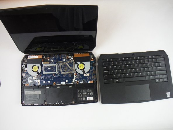

  12. Dell Alienware 13 Touch pad Replacement: crwdns2935265:012crwdnd2935265:01crwdnd2935265:02crwdne2935265:0 Dell Alienware 13 Touch pad Replacement: crwdns2935265:012crwdnd2935265:02crwdnd2935265:02crwdne2935265:0
    • Lift the computer base slightly towards you and push the release tabs on the palm-rest assembly until it pops out using a spudger.

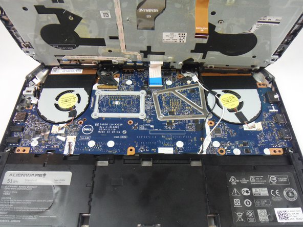

  13. Dell Alienware 13 Touch pad Replacement: crwdns2935265:013crwdnd2935265:01crwdnd2935265:03crwdne2935265:0 Dell Alienware 13 Touch pad Replacement: crwdns2935265:013crwdnd2935265:02crwdnd2935265:03crwdne2935265:0 Dell Alienware 13 Touch pad Replacement: crwdns2935265:013crwdnd2935265:03crwdnd2935265:03crwdne2935265:0
    • Turn the computer over and open the display as far as possible.
    • Using a plastic spudger, pry up along the edges of the palm-rest assembly.
    • Gently lift the palm-rest assembly.

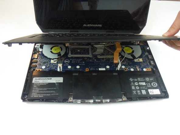

  14. Dell Alienware 13 Touch pad Replacement: crwdns2935265:014crwdnd2935265:01crwdnd2935265:03crwdne2935265:0 Dell Alienware 13 Touch pad Replacement: crwdns2935265:014crwdnd2935265:02crwdnd2935265:03crwdne2935265:0 Dell Alienware 13 Touch pad Replacement: crwdns2935265:014crwdnd2935265:03crwdnd2935265:03crwdne2935265:0

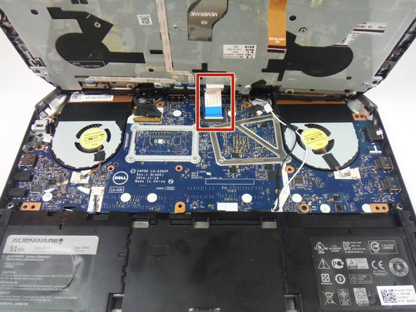

    • Lift the connector latch and disconnect the power-button board cable from the system board. Identified as a cable with a blue tab.
    • Lift the palm-rest assembly off the computer base.

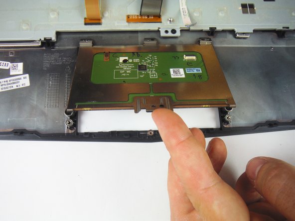

  15. Dell Alienware 13 Touch pad Replacement: crwdns2935265:015crwdnd2935265:01crwdnd2935265:02crwdne2935265:0 Dell Alienware 13 Touch pad Replacement: crwdns2935265:015crwdnd2935265:02crwdnd2935265:02crwdne2935265:0

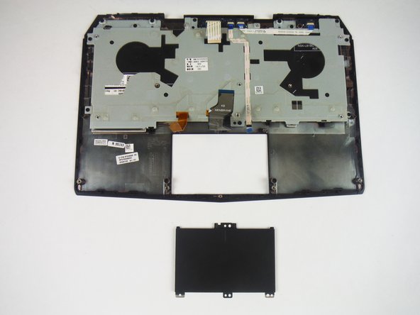

    • Disconnect the touch pad cable from the touch pad.
  16. Dell Alienware 13 Touch pad Replacement: crwdns2935265:016crwdnd2935265:01crwdnd2935265:03crwdne2935265:0 Dell Alienware 13 Touch pad Replacement: crwdns2935265:016crwdnd2935265:02crwdnd2935265:03crwdne2935265:0 Dell Alienware 13 Touch pad Replacement: crwdns2935265:016crwdnd2935265:03crwdnd2935265:03crwdne2935265:0
    • Remove (4) 3 mm Phillips head screws securing the touch pad to the palm rest assembly using a Phillips # 0 screwdriver.
    • Lift up and remove the touch pad from the palm rest assembly.
