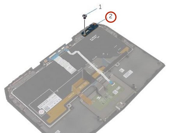

  35. Dell Alienware 13 Status-Light Board Replacement, Disconnecting the Status-Light Board: crwdns2935265:042crwdnd2935265:01crwdnd2935265:02crwdne2935265:0 Dell Alienware 13 Status-Light Board Replacement, Disconnecting the Status-Light Board: crwdns2935265:042crwdnd2935265:02crwdnd2935265:02crwdne2935265:0
    • WARNING: Before working inside your computer, read the safety information that shipped with your computer and follow the steps in Before Working Inside Your Computer. After working inside your computer, follow the instructions in After Working Inside Your Computer.
    • Lift the connector latch and disconnect the status-light board cable from the status-light board.
  36. Dell Alienware 13 Status-Light Board Replacement, Remove the Screw: crwdns2935265:043crwdnd2935265:01crwdnd2935265:02crwdne2935265:0 Dell Alienware 13 Status-Light Board Replacement, Remove the Screw: crwdns2935265:043crwdnd2935265:02crwdnd2935265:02crwdne2935265:0
    • Remove the screw that secures the status-light board to the palm-rest assembly.
  37. Dell Alienware 13 Status-Light Board Replacement, Removing the Status-Light Board: crwdns2935265:044crwdnd2935265:01crwdnd2935265:01crwdne2935265:0
    • Lift the status-light board off the palm-rest assembly.
  38. Dell Alienware 13 Status-Light Board Replacement, Securing the Cable: crwdns2935265:045crwdnd2935265:01crwdnd2935265:01crwdne2935265:0
    • Slide the NEW status-light board cable into the status-light board connector and press down the latch to secure the cable.
    • Align the screw hole on the status-light board with the screw hole on the palm-rest assembly.
  39. Dell Alienware 13 Status-Light Board Replacement, Replace the Screw: crwdns2935265:047crwdnd2935265:01crwdnd2935265:01crwdne2935265:0
    • Replace the screw that secures the status-light board to the palm-rest assembly.
