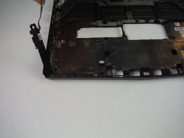

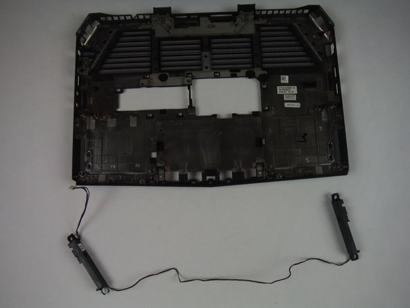

  27. Dell Alienware 13 Speakers Replacement, Speakers: crwdns2935265:027crwdnd2935265:01crwdnd2935265:03crwdne2935265:0 Dell Alienware 13 Speakers Replacement, Speakers: crwdns2935265:027crwdnd2935265:02crwdnd2935265:03crwdne2935265:0 Dell Alienware 13 Speakers Replacement, Speakers: crwdns2935265:027crwdnd2935265:03crwdnd2935265:03crwdne2935265:0
    • After removing the battery, lift up on the speakers and wires to fully removed from the base panel.
