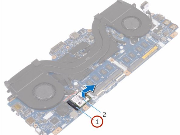

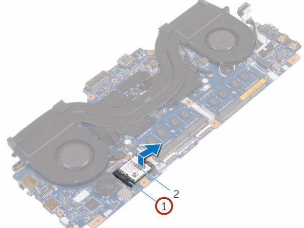

  47. Dell Alienware 13 R2 Wireless Card Replacement, Remove the Screw: crwdns2935265:064crwdnd2935265:01crwdnd2935265:01crwdne2935265:0
    • WARNING: Before working inside your computer, read the safety information that shipped with your computer and follow the steps in Before Working Inside Your Computer. After working inside your computer, follow the instructions in After Working Inside Your Computer.
    • Remove the screw that secures the power-adapter port bracket to the power-adapter port.
  48. Dell Alienware 13 R2 Wireless Card Replacement, Lifting the Power-Adapter: crwdns2935265:065crwdnd2935265:01crwdnd2935265:01crwdne2935265:0
    • Lift the power-adapter port bracket off the power-adapter port.
    • Release the power-adapter port from the computer base.
  49. Dell Alienware 13 R2 Wireless Card Replacement, Disconnecting the Speaker Cable: crwdns2935265:067crwdnd2935265:01crwdnd2935265:01crwdne2935265:0
    • Disconnect the speaker cable from the system board.
  50. Dell Alienware 13 R2 Wireless Card Replacement, Remove the Screws: crwdns2935265:068crwdnd2935265:01crwdnd2935265:01crwdne2935265:0
    • Remove the screws that secure the system board to the computer base.
  51. Dell Alienware 13 R2 Wireless Card Replacement, Lifting the System Board Assembly: crwdns2935265:069crwdnd2935265:01crwdnd2935265:01crwdne2935265:0
    • Slide and lift the system-board assembly.
    • Turn the system-board assembly over.
  52. Dell Alienware 13 R2 Wireless Card Replacement, Disconnecting the Power-Adapter Port: crwdns2935265:071crwdnd2935265:01crwdnd2935265:01crwdne2935265:0
    • Disconnect the power-adapter port cable and remove the power-adapter port from the system board.
    • Connect the power-adapter port cable to the system board.
    • Turn the system board over.

  56. Dell Alienware 13 R2 Wireless Card Replacement, Slide the Wireless Card: crwdns2935265:079crwdnd2935265:01crwdnd2935265:02crwdne2935265:0 Dell Alienware 13 R2 Wireless Card Replacement, Slide the Wireless Card: crwdns2935265:079crwdnd2935265:02crwdnd2935265:02crwdne2935265:0
  57. Dell Alienware 13 R2 Wireless Card Replacement, Sliding the Wireless Card: crwdns2935265:080crwdnd2935265:01crwdnd2935265:02crwdne2935265:0 Dell Alienware 13 R2 Wireless Card Replacement, Sliding the Wireless Card: crwdns2935265:080crwdnd2935265:02crwdnd2935265:02crwdne2935265:0
    • Slide the NEW wireless card into the wireless-card slot on the system board.
