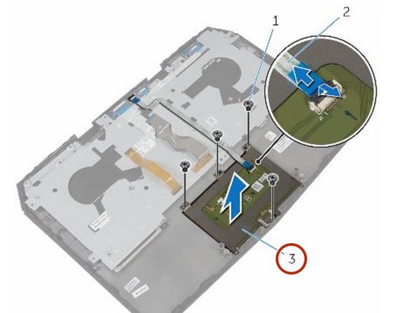

    • Remove the screws that secure the touchpad to the palm-rest assembly.
  32. Dell Alienware 13 R2 Touch Pad Replacement, Lift the Touchpad: crwdns2935265:040crwdnd2935265:01crwdnd2935265:01crwdne2935265:0
    • Lift the touchpad off the palm-rest assembly.
  33. Dell Alienware 13 R2 Touch Pad Replacement, Align the Screw Holes: crwdns2935265:041crwdnd2935265:01crwdnd2935265:01crwdne2935265:0
    • Align the screw holes on the touchpad with the screw holes on the palm-rest assembly.
    • Replace the screws that secure the touchpad to the palm-rest assembly.
    • Slide the touchpad cable into the touchpad connector and press down the latch to secure the cable.
