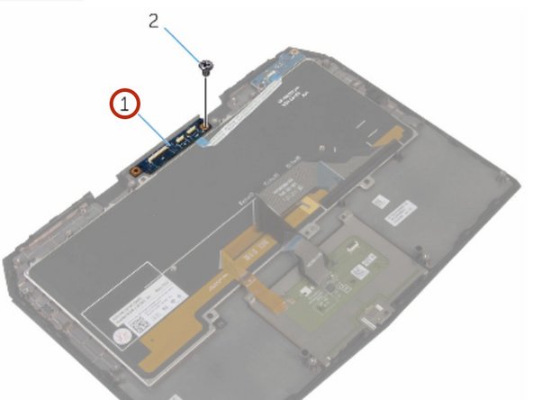

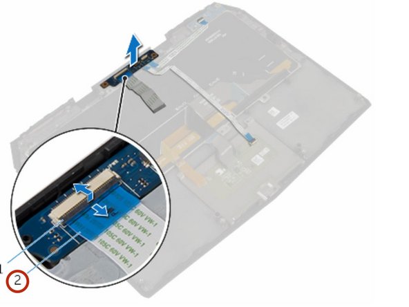

  39. Dell Alienware 13 R2 Power-Button Board Replacement, Disconnecting the Power-Button Board Cable: crwdns2935265:050crwdnd2935265:01crwdnd2935265:02crwdne2935265:0 Dell Alienware 13 R2 Power-Button Board Replacement, Disconnecting the Power-Button Board Cable: crwdns2935265:050crwdnd2935265:02crwdnd2935265:02crwdne2935265:0
    • WARNING: Before working inside your computer, read the safety information that shipped with your computer and follow the steps in Before Working Inside Your Computer. After working inside your computer, follow the instructions in After Working Inside Your Computer.
    • Lift the connector latch and disconnect the power-button board cable from the power-button board.
  40. Dell Alienware 13 R2 Power-Button Board Replacement, Remove the Screw: crwdns2935265:051crwdnd2935265:01crwdnd2935265:02crwdne2935265:0 Dell Alienware 13 R2 Power-Button Board Replacement, Remove the Screw: crwdns2935265:051crwdnd2935265:02crwdnd2935265:02crwdne2935265:0
    • Remove the screw that secures the power-button board to the palm-rest assembly.
    • Slide the power-button board cable into the power-button board connector and press down the latch to secure the cable.
  41. Dell Alienware 13 R2 Power-Button Board Replacement, Align the Screw Hole: crwdns2935265:053crwdnd2935265:01crwdnd2935265:01crwdne2935265:0
    • Align the screw hole on the NEW power-button board with the screw hole on the palm-rest assembly.
  42. Dell Alienware 13 R2 Power-Button Board Replacement, Replace the Screw: crwdns2935265:054crwdnd2935265:01crwdnd2935265:01crwdne2935265:0
    • Replace the screw that secures the power-button board to the palm-rest assembly.
