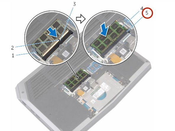

    • Using your fingertips, carefully spread apart the securing clips on each end of the memory-module slot until the memory module pops up.
  2. Dell Alienware 13 R2 Memory Modules Replacement, Removing the Memory Module: crwdns2935265:02crwdnd2935265:01crwdnd2935265:01crwdne2935265:0
    • Slide and remove the memory module from the memory-module slot.
  3. Dell Alienware 13 R2 Memory Modules Replacement, Align the notches: crwdns2935265:03crwdnd2935265:01crwdnd2935265:01crwdne2935265:0
    • Using the new memory module, align the notch on the memory module with the tab on the memory-module slot.
  4. Dell Alienware 13 R2 Memory Modules Replacement, Sliding the Memory Module: crwdns2935265:04crwdnd2935265:01crwdnd2935265:02crwdne2935265:0 Dell Alienware 13 R2 Memory Modules Replacement, Sliding the Memory Module: crwdns2935265:04crwdnd2935265:02crwdnd2935265:02crwdne2935265:0
    • Slide the memory module firmly into the slot at an angle and press the memory module down until it clicks into place.
