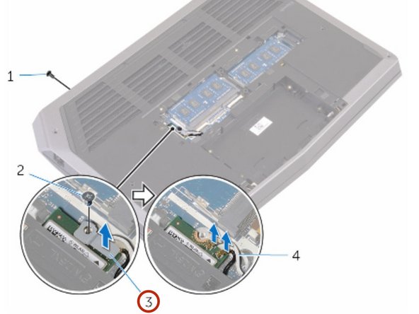

    • Remove the screw that secures the wireless-card bracket to the wireless card.
  34. Dell Alienware 13 R2 Display Panel Replacement, Disconnect the Antenna Cables: crwdns2935265:043crwdnd2935265:01crwdnd2935265:01crwdne2935265:0
    • Disconnect the antenna cables from the wireless card.

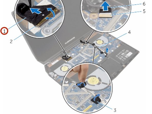

  36. Dell Alienware 13 R2 Display Panel Replacement, Disconnect the Display Cable: crwdns2935265:046crwdnd2935265:01crwdnd2935265:02crwdne2935265:0 Dell Alienware 13 R2 Display Panel Replacement, Disconnect the Display Cable: crwdns2935265:046crwdnd2935265:02crwdnd2935265:02crwdne2935265:0
    • Lift the connector latch and disconnect the display cable from the system board.
  37. Dell Alienware 13 R2 Display Panel Replacement, Remove the Display Cable: crwdns2935265:047crwdnd2935265:01crwdnd2935265:02crwdne2935265:0 Dell Alienware 13 R2 Display Panel Replacement, Remove the Display Cable: crwdns2935265:047crwdnd2935265:02crwdnd2935265:02crwdne2935265:0
    • Remove the display cable from the routing guides on the display hinges.
  38. Dell Alienware 13 R2 Display Panel Replacement, Disconnect the Logo-Board Cable: crwdns2935265:048crwdnd2935265:01crwdnd2935265:01crwdne2935265:0
    • Disconnect the logo-board cable from the system board and remove it from the routing guides on the display hinges.

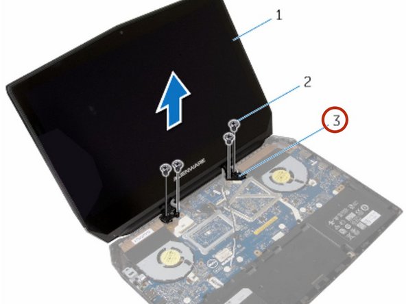

  39. Dell Alienware 13 R2 Display Panel Replacement, Remove the Screws: crwdns2935265:049crwdnd2935265:01crwdnd2935265:01crwdne2935265:0
    • Remove the screws that secure the display assembly to the computer base.
    • Lift the display assembly off the computer base.

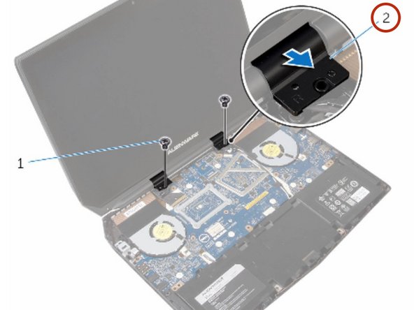

  40. Dell Alienware 13 R2 Display Panel Replacement, Align the Screw Holes: crwdns2935265:051crwdnd2935265:01crwdnd2935265:01crwdne2935265:0
    • Align the screw holes on the display hinges with the screw holes on the computer base.
  41. Dell Alienware 13 R2 Display Panel Replacement, Replace the Screws: crwdns2935265:052crwdnd2935265:01crwdnd2935265:01crwdne2935265:0
    • Replace the screws that secure the display hinges to the computer base.

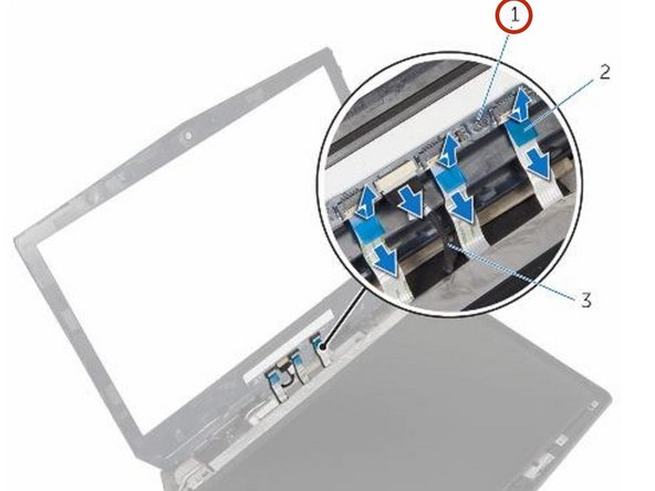

  48. Dell Alienware 13 R2 Display Panel Replacement, Lifting the Latches: crwdns2935265:066crwdnd2935265:01crwdnd2935265:01crwdne2935265:0
    • Lift the connector latches and disconnect the display-board cables from the logo board.
  49. Dell Alienware 13 R2 Display Panel Replacement, Disconnect the Logo-Board Cable: crwdns2935265:067crwdnd2935265:01crwdnd2935265:02crwdne2935265:0 Dell Alienware 13 R2 Display Panel Replacement, Disconnect the Logo-Board Cable: crwdns2935265:067crwdnd2935265:02crwdnd2935265:02crwdne2935265:0
    • Disconnect the logo-board cable from the logo board.
  50. Dell Alienware 13 R2 Display Panel Replacement, Connect the Logo Board Cable: crwdns2935265:068crwdnd2935265:01crwdnd2935265:01crwdne2935265:0
    • Connect the logo-board cable to the logo board.
  51. Dell Alienware 13 R2 Display Panel Replacement, Slide the Display-Board Cables: crwdns2935265:069crwdnd2935265:01crwdnd2935265:01crwdne2935265:0
    • Slide the display-board cables to their respective connectors on the logo board and press down the latches to secure the cables.

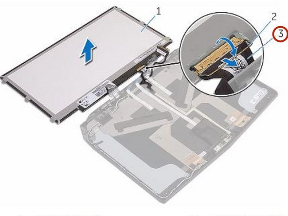

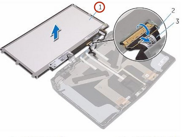

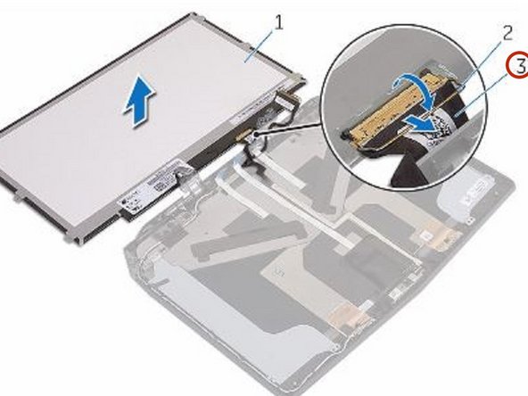

  54. Dell Alienware 13 R2 Display Panel Replacement, Lift the Display Panel: crwdns2935265:073crwdnd2935265:01crwdnd2935265:01crwdne2935265:0
    • Gently lift the display panel and turn it over.
  55. Dell Alienware 13 R2 Display Panel Replacement, Disconnecting the Display Cable: crwdns2935265:074crwdnd2935265:01crwdnd2935265:02crwdne2935265:0 Dell Alienware 13 R2 Display Panel Replacement, Disconnecting the Display Cable: crwdns2935265:074crwdnd2935265:02crwdnd2935265:02crwdne2935265:0
    • Lift the connector latch and disconnect the display cable from the display panel.
  56. Dell Alienware 13 R2 Display Panel Replacement, Connect the Display Cable: crwdns2935265:075crwdnd2935265:01crwdnd2935265:01crwdne2935265:0
    • Connect the NEW display cable to the display panel and press down on the connector latch to secure the cable.
    • Turn the display panel over.
  57. Dell Alienware 13 R2 Display Panel Replacement, Lifting the Latch: crwdns2935265:078crwdnd2935265:01crwdnd2935265:03crwdne2935265:0 Dell Alienware 13 R2 Display Panel Replacement, Lifting the Latch: crwdns2935265:078crwdnd2935265:02crwdnd2935265:03crwdne2935265:0 Dell Alienware 13 R2 Display Panel Replacement, Lifting the Latch: crwdns2935265:078crwdnd2935265:03crwdnd2935265:03crwdne2935265:0
  58. Dell Alienware 13 R2 Display Panel Replacement, Securing the Cable: crwdns2935265:079crwdnd2935265:01crwdnd2935265:01crwdne2935265:0
  59. Dell Alienware 13 R2 Display Panel Replacement, Align the Screw Holes: crwdns2935265:081crwdnd2935265:01crwdnd2935265:01crwdne2935265:0
    • Align the screw holes on the display panel with the screw holes on the display back-cover.
  60. Dell Alienware 13 R2 Display Panel Replacement, Replace the Screws: crwdns2935265:082crwdnd2935265:01crwdnd2935265:01crwdne2935265:0
    • Replace the screws that secure the display panel to the display back-cover.
