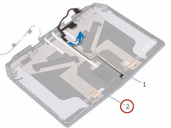

  54. Dell Alienware 13 R2 Display Back-Cover Replacement, Lift the Display Panel: crwdns2935265:073crwdnd2935265:01crwdnd2935265:01crwdne2935265:0
    • Gently lift the display panel and turn it over.
  55. Dell Alienware 13 R2 Display Back-Cover Replacement, Disconnecting the Display Cable: crwdns2935265:074crwdnd2935265:01crwdnd2935265:02crwdne2935265:0 Dell Alienware 13 R2 Display Back-Cover Replacement, Disconnecting the Display Cable: crwdns2935265:074crwdnd2935265:02crwdnd2935265:02crwdne2935265:0

  70. Dell Alienware 13 R2 Display Back-Cover Replacement, Peel the Display-Board Cable: crwdns2935265:092crwdnd2935265:01crwdnd2935265:01crwdne2935265:0
  71. Dell Alienware 13 R2 Display Back-Cover Replacement, Peel the Camera Cable: crwdns2935265:093crwdnd2935265:01crwdnd2935265:02crwdne2935265:0 Dell Alienware 13 R2 Display Back-Cover Replacement, Peel the Camera Cable: crwdns2935265:093crwdnd2935265:02crwdnd2935265:02crwdne2935265:0
    • Note the display cable routing and peel the camera cable off the display back-cover.
