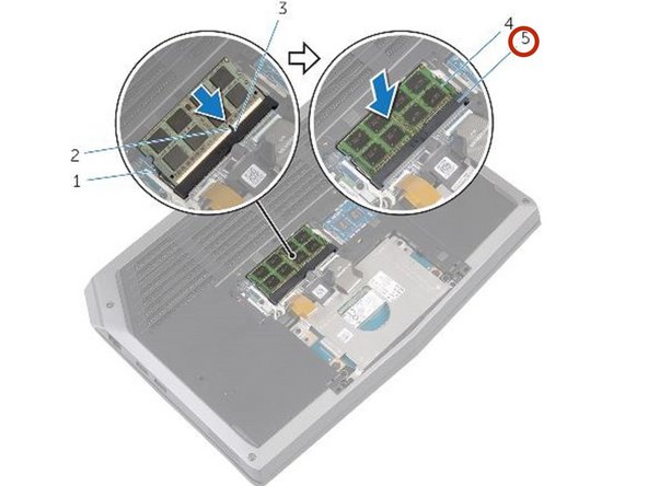

      • Using your fingertips, carefully spread apart the securing clips on each end of the memory-module slot until the memory module pops up.
    2. Dell Alienware 13 Memory Module Replacement, Removing the Memory Module: crwdns2935265:02crwdnd2935265:01crwdnd2935265:01crwdne2935265:0
      • Slide and remove the memory module from the memory-module slot.
    3. Dell Alienware 13 Memory Module Replacement, Aligning the new Memory Module: crwdns2935265:03crwdnd2935265:01crwdnd2935265:02crwdne2935265:0 Dell Alienware 13 Memory Module Replacement, Aligning the new Memory Module: crwdns2935265:03crwdnd2935265:02crwdnd2935265:02crwdne2935265:0
      • Align the notch on the NEW memory module with the tab on the memory-module slot.
