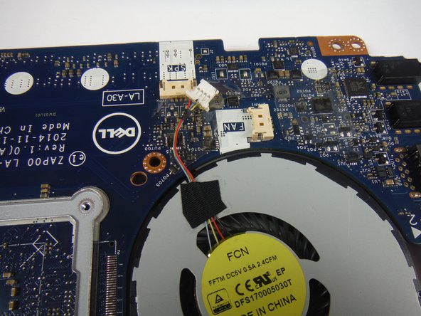

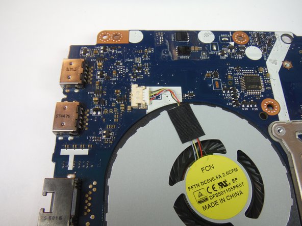

  25. Dell Alienware 13 Heat-sink Assembly Replacement, Heat-sink Assembly: crwdns2935265:025crwdnd2935265:01crwdnd2935265:03crwdne2935265:0 Dell Alienware 13 Heat-sink Assembly Replacement, Heat-sink Assembly: crwdns2935265:025crwdnd2935265:02crwdnd2935265:03crwdne2935265:0 Dell Alienware 13 Heat-sink Assembly Replacement, Heat-sink Assembly: crwdns2935265:025crwdnd2935265:03crwdnd2935265:03crwdne2935265:0
    • The heat-sink assembly can get very hot during computer use. Let the computer cool off before touching the heat-sink assembly.
    • Oils from hands can reduce the efficiency of the heat transfer capabilities. Avoid direct contact with the heat transfer areas as much as possible.
    • Disconnect (2) fan cables attaching the fans to the motherboard.

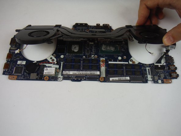

  26. Dell Alienware 13 Heat-sink Assembly Replacement: crwdns2935265:026crwdnd2935265:01crwdnd2935265:02crwdne2935265:0 Dell Alienware 13 Heat-sink Assembly Replacement: crwdns2935265:026crwdnd2935265:02crwdnd2935265:02crwdne2935265:0
    • Turn the system board over.
    • Remove the (7) 3 mm Phillips head screws attaching the heat-sink assembly to the system board with a #0 Phillips screwdriver.
    • Lift up and remove the heat-sink assembly.
