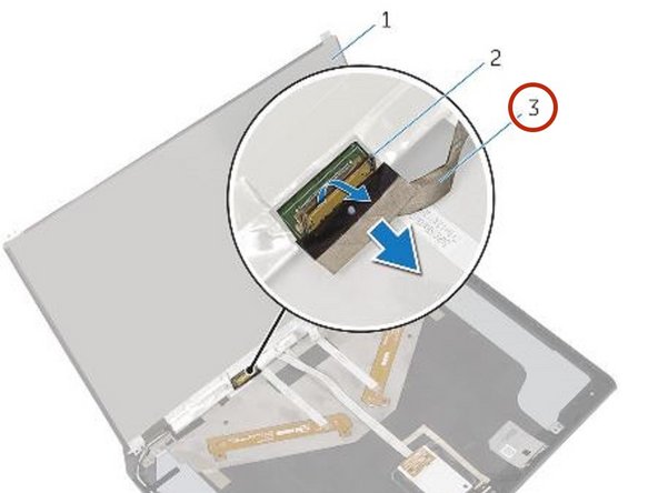

  34. Dell Alienware 13 Display Back-Cover Replacement, Disconnecting the Display Cable: crwdns2935265:041crwdnd2935265:01crwdnd2935265:02crwdne2935265:0 Dell Alienware 13 Display Back-Cover Replacement, Disconnecting the Display Cable: crwdns2935265:041crwdnd2935265:02crwdnd2935265:02crwdne2935265:0
    • Lift the connector latch and disconnect the display cable from the system board.
  35. Dell Alienware 13 Display Back-Cover Replacement, Removing the Display Cable: crwdns2935265:042crwdnd2935265:01crwdnd2935265:01crwdne2935265:0
    • Remove the display cable from the routing guides on the display hinges.

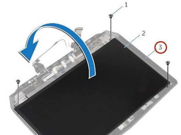

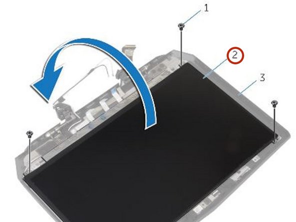

  63. Dell Alienware 13 Display Back-Cover Replacement, Remove the Screws: crwdns2935265:079crwdnd2935265:01crwdnd2935265:03crwdne2935265:0 Dell Alienware 13 Display Back-Cover Replacement, Remove the Screws: crwdns2935265:079crwdnd2935265:02crwdnd2935265:03crwdne2935265:0 Dell Alienware 13 Display Back-Cover Replacement, Remove the Screws: crwdns2935265:079crwdnd2935265:03crwdnd2935265:03crwdne2935265:0
    • Remove the screws that secure the display panel to the display back-cover.
  64. Dell Alienware 13 Display Back-Cover Replacement, Lift the Display Panel: crwdns2935265:080crwdnd2935265:01crwdnd2935265:01crwdne2935265:0
    • Gently lift the display panel and turn it over.

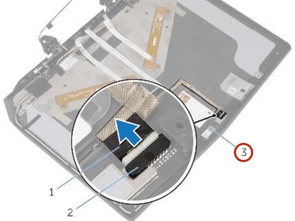

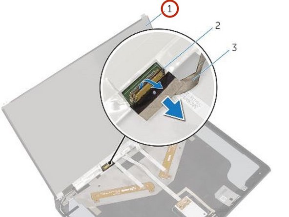

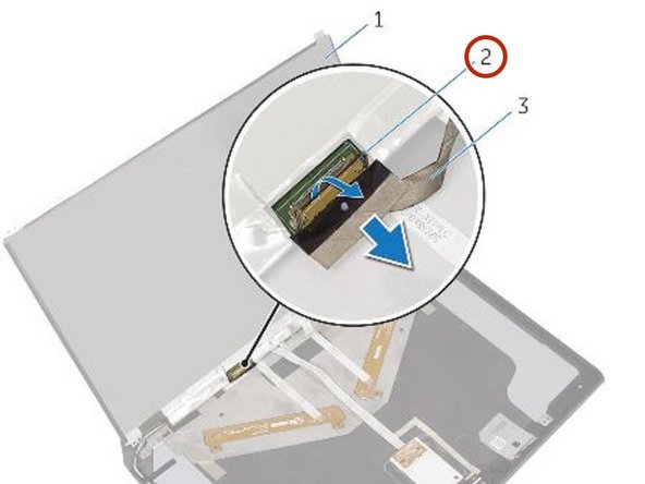

  65. Dell Alienware 13 Display Back-Cover Replacement, Lift the Connector Latch: crwdns2935265:081crwdnd2935265:01crwdnd2935265:03crwdne2935265:0 Dell Alienware 13 Display Back-Cover Replacement, Lift the Connector Latch: crwdns2935265:081crwdnd2935265:02crwdnd2935265:03crwdne2935265:0 Dell Alienware 13 Display Back-Cover Replacement, Lift the Connector Latch: crwdns2935265:081crwdnd2935265:03crwdnd2935265:03crwdne2935265:0
    • Lift the connector latch and disconnect the display cable from the display panel.

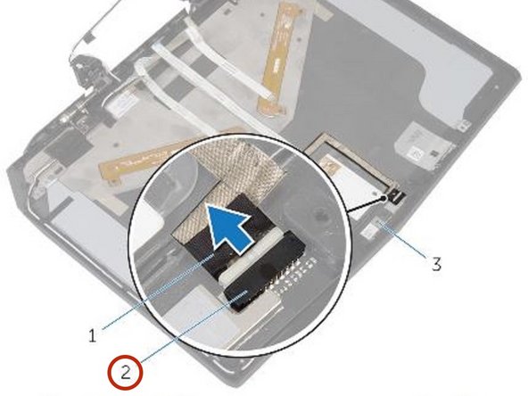

  66. Dell Alienware 13 Display Back-Cover Replacement, Securing the Cable: crwdns2935265:082crwdnd2935265:01crwdnd2935265:03crwdne2935265:0 Dell Alienware 13 Display Back-Cover Replacement, Securing the Cable: crwdns2935265:082crwdnd2935265:02crwdnd2935265:03crwdne2935265:0 Dell Alienware 13 Display Back-Cover Replacement, Securing the Cable: crwdns2935265:082crwdnd2935265:03crwdnd2935265:03crwdne2935265:0
    • Connect the display cable to the NEW display panel and press down on the connector latch to secure the cable.
    • Turn the display panel over.
  67. Dell Alienware 13 Display Back-Cover Replacement, Align the Screw Holes: crwdns2935265:084crwdnd2935265:01crwdnd2935265:01crwdne2935265:0

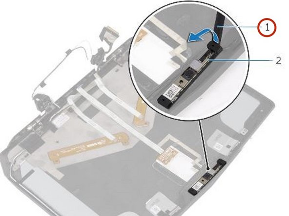

  71. Dell Alienware 13 Display Back-Cover Replacement, Pry the Camera Module: crwdns2935265:088crwdnd2935265:01crwdnd2935265:02crwdne2935265:0 Dell Alienware 13 Display Back-Cover Replacement, Pry the Camera Module: crwdns2935265:088crwdnd2935265:02crwdnd2935265:02crwdne2935265:0
    • Using a plastic scribe, pry the camera module off the display back-cover.
