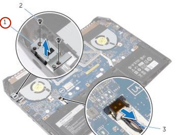

    • Remove the screw that secures the power-adapter port bracket to the power-adapter port.
  36. Dell Alienware 13 Coin-Cell Battery Replacement, Lift the Power-Adapter: crwdns2935265:043crwdnd2935265:01crwdnd2935265:01crwdne2935265:0
    • Lift the power-adapter port bracket off the power-adapter port.
    • Release the power-adapter port from the computer base.
  37. Dell Alienware 13 Coin-Cell Battery Replacement, Disconnect the Speaker Cable: crwdns2935265:045crwdnd2935265:01crwdnd2935265:01crwdne2935265:0
    • Disconnect the speaker cable from the system board.
  38. Dell Alienware 13 Coin-Cell Battery Replacement, Remove the Screws: crwdns2935265:046crwdnd2935265:01crwdnd2935265:01crwdne2935265:0
    • Remove the screws that secure the system board to the computer base.
  39. Dell Alienware 13 Coin-Cell Battery Replacement, Slide and Lift the System-Board Assembly: crwdns2935265:047crwdnd2935265:01crwdnd2935265:01crwdne2935265:0
    • Slide and lift the system-board assembly.
    • Turn the system-board assembly over.
  40. Dell Alienware 13 Coin-Cell Battery Replacement, Disconnect the Power-Adapter Port Cable: crwdns2935265:049crwdnd2935265:01crwdnd2935265:01crwdne2935265:0
    • Disconnect the power-adapter port cable and remove the power-adapter port from the system board.

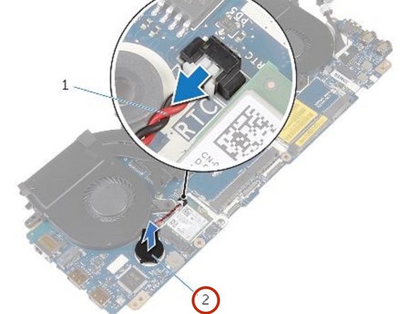

  45. Dell Alienware 13 Coin-Cell Battery Replacement, Disconnecting the Coin-Cell Battery Cable: crwdns2935265:057crwdnd2935265:01crwdnd2935265:02crwdne2935265:0 Dell Alienware 13 Coin-Cell Battery Replacement, Disconnecting the Coin-Cell Battery Cable: crwdns2935265:057crwdnd2935265:02crwdnd2935265:02crwdne2935265:0
    • WARNING: Before working inside your computer, read the safety information that shipped with your computer and follow the steps in Before Working Inside Your Computer. After working inside your computer, follow the instructions in After Working Inside Your Computer.
    • Disconnect the coin-cell battery cable from the connector on the system board.
    • Peel the coin-cell battery off the system board.
  46. Dell Alienware 13 Coin-Cell Battery Replacement, Adhering the Coin-Cell Battery: crwdns2935265:059crwdnd2935265:01crwdnd2935265:01crwdne2935265:0
    • Adhere the NEW coin-cell battery to the system board.
  47. Dell Alienware 13 Coin-Cell Battery Replacement, Connect the Coin-Cell Battery: crwdns2935265:060crwdnd2935265:01crwdnd2935265:01crwdne2935265:0
    • Connect the coin-cell battery cable to the connector on the system board.
