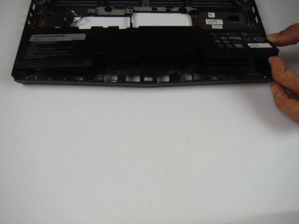

  25. Dell Alienware 13 Battery Replacement, Battery: crwdns2935265:025crwdnd2935265:01crwdnd2935265:01crwdne2935265:0
    • Remove the speaker cable from the cable clip on the battery.

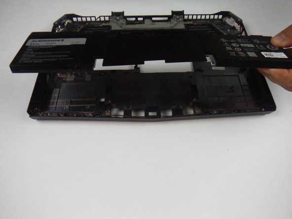

  26. Dell Alienware 13 Battery Replacement: crwdns2935265:026crwdnd2935265:01crwdnd2935265:03crwdne2935265:0 Dell Alienware 13 Battery Replacement: crwdns2935265:026crwdnd2935265:02crwdnd2935265:03crwdne2935265:0 Dell Alienware 13 Battery Replacement: crwdns2935265:026crwdnd2935265:03crwdnd2935265:03crwdne2935265:0
    • Remove (2) 6 mm Phillips head screws securing the battery to the computer base with a #1 Phillips screwdriver.
    • Lift up and remove the battery from the computer base.
    • Lithium can be explosive, especially when wet. Be careful when handling and disposing of lithium-ion batteries.
