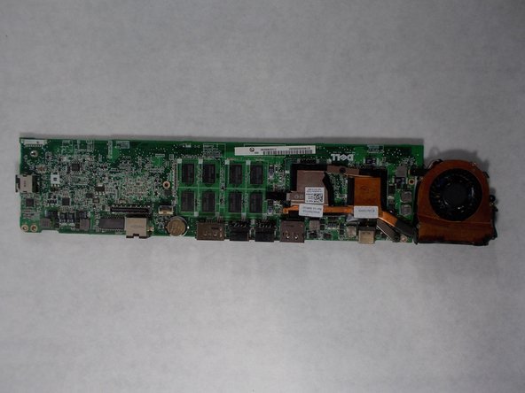

    • Using the Phillips #0 screwdriver, remove six 2 mm screws securing the fan and motherboard to the device.
  5. Dell Adamo 13 Motherboard Replacement: crwdns2935265:05crwdnd2935265:01crwdnd2935265:03crwdne2935265:0 Dell Adamo 13 Motherboard Replacement: crwdns2935265:05crwdnd2935265:02crwdnd2935265:03crwdne2935265:0 Dell Adamo 13 Motherboard Replacement: crwdns2935265:05crwdnd2935265:03crwdnd2935265:03crwdne2935265:0

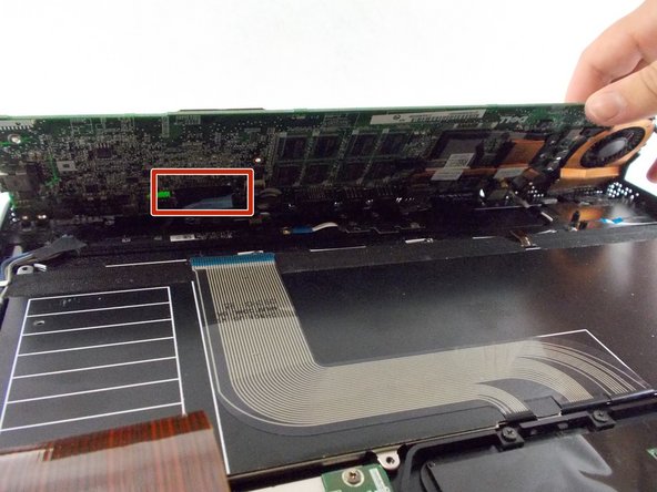

    • Remove all the connections to the circuit board on top and underneath.
    • Use caution when removing connections to prevent damage.
    • Remove the motherboard from the device.
